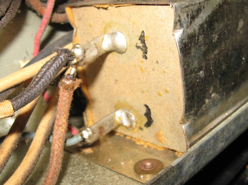

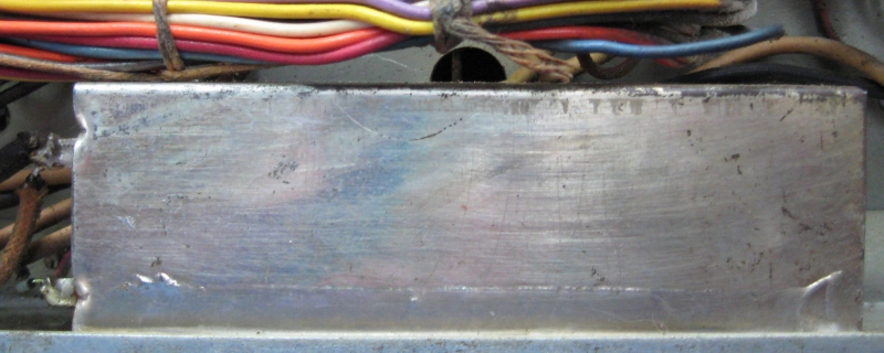

Sure looks like an original part to me. Are we taking about the same part? Like i said on the case of this is printed 5 Mfd 300 VDC. The DC part is throwing me off. All the motor caps i see are AC. Please stop using big words like stepper. :D :D . Remember this jukebox stuff is new to me.

Hi Stan,
Yep--attza da one (small enough words for you ?) RTFM !! :lol:

I don't recall ever seeing it marked "DC" ( or anything else other then the terminal markings--3 and 4--, and if you would, RTFM, you would note it's directly connected to the transformer winding---

Stan Ski wrote:Now i am confused again. Is this a motor type cap? If it is then is it used for start or run. Or is is just a good old standard mylar cap. I looked at Mousers and only found a few motor caps that were DC
Stan Ski
Stan, sorry about the confusion here. yes, this is a non-polarized cap (AC) because it has elements of both AC and DC across it.
Its purpose here is to strengthen and slightly lengthen the pulses coming through the 2050. In this circuit that tube conducts to produce positive pules of current at approx 150 vdc. It therefore not only acts as a relay-current amplifier, but rectifier too. In fact, it can be replaced with an SCr along with a triggering circuit. This is what I use to eliminate those tubes.
While you can of course replace that 5mfd cap with an oil-filled motor-run or even two electrolytic 10mfd caps negative to negative in series (this produces 5mfd non-polarized) I have long chosen the mylar caps because they are much more accurate in value and don't change over time.
They are also smaller and getting rid of that large cap allows convenient space for mounting a relay to control the amplifier tube heaters and a terminal strip with diodes, resistor and fuse to eliminate the 6X4 tube on the Tormat equipped machines.
I hope this explanation hasn't added to the confusion :-)
