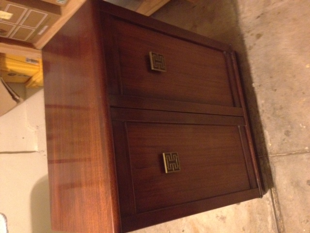

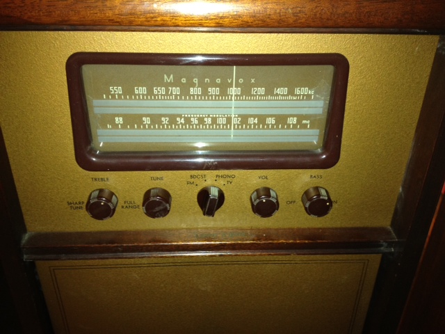

Hey, found the site after a number of searches. Im looking for some information and some advice on a magnovox console I picked up last weekend. I bought it at an estate sale, the owner was a 90yr old fellow who was going into a nursing home. Ive always been into old mechanical stuff - typewriters, old lionel trains and such, so I figured what the heck - it was $100 bucks with about 30 records included.
Everything works Ok, but from reading around, I got a few questions...
First question...
Anyone know when about it was made? I found this site http://www.antiqueradiomuseum.org/consoleradios.htm and the picture is very close, he calls it a 477p. I know that from the back (see pics) the information says:
Model 250M
Watts 130
Style G180-23
Volts 117
Serial 520249
And the stamp on the back of the chassis says 323 CB 3 16 4
But nowhere do I find a model 250m on the internet, nor do I find a 477 on the console itself.

You'll have to look or ask around for someone who can restore the amplifier and tuner in your area. If those caps and/or other components are way out of spec they will go and will take other components with them: tubes $$ or a transformer $$$$$$$$. You should have some electronic backround to do this correctly. These aren't simple little one-tube-wonders, and they can bite. You will be amazed at the quality of sound. I do think you could send the amp and tunner units out without the cabinet if the service tech has the means to bench test them.
