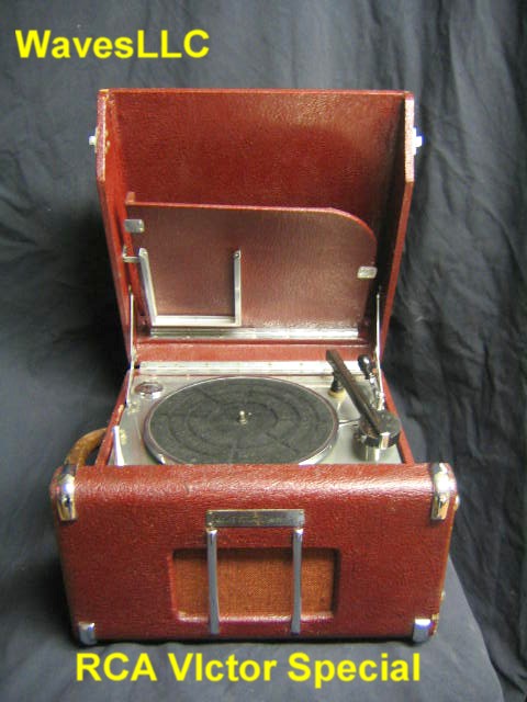

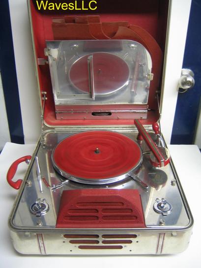

I think that the main reason more portable phonographs were not battery or AC/DC powered was because the power consumption required for both the turntable and the amplifier was too great, and the batteries would drain quickly. There were some portable phonographs produced, starting in the 1930s, that used a wind-up motor for the turntable and batteries for the electrically amplified speaker/cartridge, such as the famous RCA Special models:
