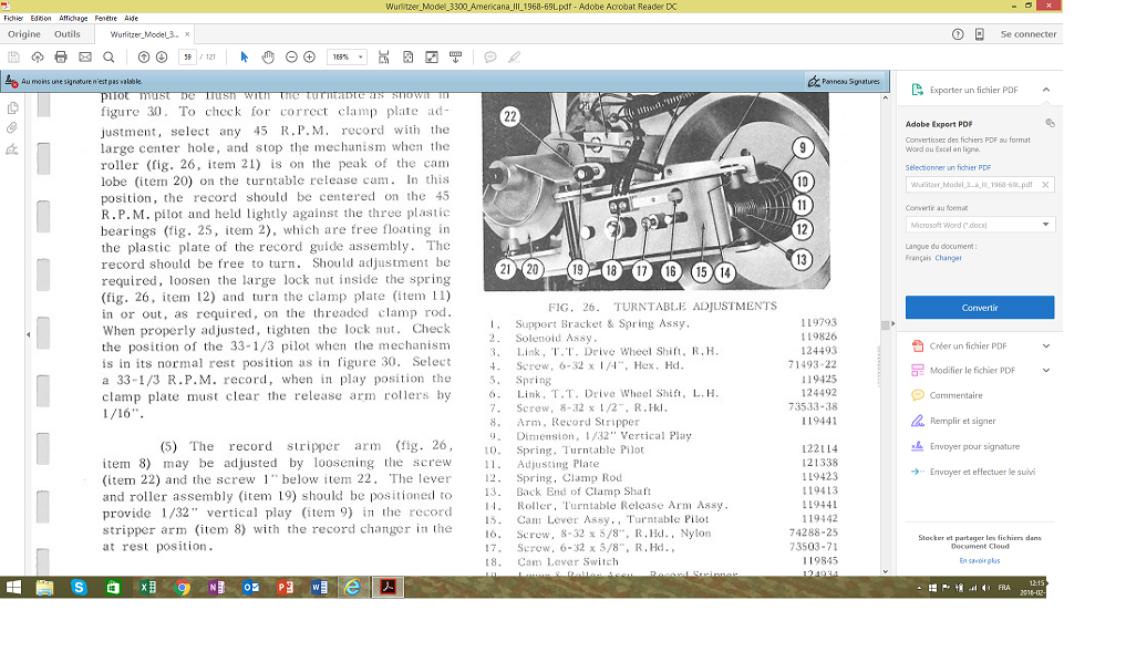

Ok, this video answers it: https://www.youtube.com/watch?v=Gfp5Rqm_Mbo
The 45 pilot is not being driven forward enough. I was wrong about the stripper lever (couldn't see its action previously).
Go to Pg59 on the PDF and carefully adjust item 11 "adjusting plate" (fig 26) to move the pilot slightly forward. This can be done in the at rest mode and go slowly, There is a setscrew inside the rear spring.
I don't know why this would have gotten out of whack, The cam rollers look OK Perhaps the setscrew got loose?...or someone tinkered with it. These are very stable mechanisms and normally never need anything other than washing, lubing and a little TLC. The only thing i can think of here, other than tinkering, is that someone slightly bent the stripper plate outward for some reason. Anyway, the adjustment will take care of it.

by 0070julie » Sun Feb 14, 2016 4:39 pm
Rob-NYC wrote:Ok, this video answers it: https://www.youtube.com/watch?v=Gfp5Rqm_Mbo
Hi Rob,
Yes in previous post I mentioned that this bolt was loose, totally unscrewed from the rod. I screwed it back on, but when it was finally clamping, it was not unclamping afterwards, The record would stay stuck and not go down :)
I guess I will have to find the perfect adjustments so it clamps AND unclamps. It is hard to adjust this without the small hole pilot to be out and not flush as they say in the manual

by 0070julie » Sun Feb 14, 2016 7:31 pm
............. I think I know now why the expression ''We are screwed'' exists in English.......screws seem to be the mother of all my jukebox issues......
I saw a screw on the cam assy that caught my eye, as the star shape looked used...So I said to myself, this must do something?
Turns out that this @?%$& screw (Number 17 on the manual's pic)changes everything in the adjustmentsof the small hole pilot coming out of the turntable.....
Before that screw, everytime I was able to make records clamp, they would not Unclamp afterwards.
SO it seems that if I adjust both of these I will be able to find the ''Middle'' so that my adjusting plate is not to unscrewed to the point of the bolt in the spring falling off to be able to clamp (as this was the case when I tried before)
Now what I need to do is to find the correct adjustment with number 11 adjusting plate so that my record clamps and then use that screw (17) to correctly release the record somehow
It will be hours of fun... :D
Does this make any sense to you guys, am I on the right track here?
Thanks!!
