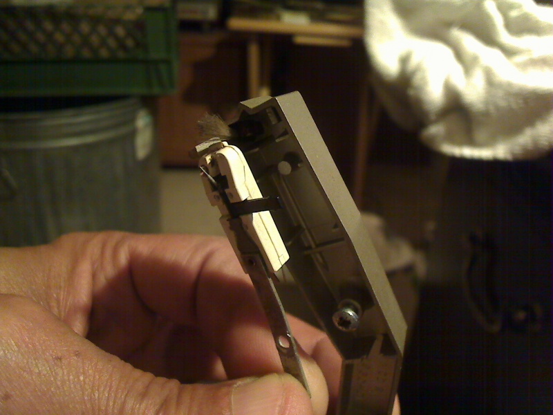

After looking at it some more and reading some posts I wanted to start by getting a new needle. I lift up the arm and I am not sure how I can get it off to see what needle replacement I need. I see a screw underneath but had a hard time unscrewing it and did not want to strip the screw. Am I heading in the right direction by getting that screw off? I did not want to proceed because I was a little nervous of breaking it and no music at all. Thanks!

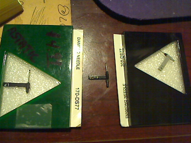

You need to find the number on the cartridge so you can make sure you get the right stylus/needle, I don't own a 68 Astrosonic but
the number may be visable without removing the cartridge from the tonearm. Once you get the number you will be on the right
track to buying the correct stylus/needle. I have bought my stylus/needles from vendors on eBay from 4.99 to 8.99 and that includes
free shipping you will have a hard time beating those prices any where else.

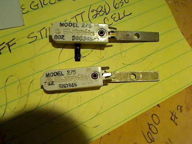

Look in the FAQ on this page at the top of Topics. You may have the popular Electrovoice EV275 or an Astatic 165D. You'll see it on the back of the cartridge, The 560345 is Magnavox number and those 802/742 numbers are the stocking/warehouse. There are several replacement needles that will work.
