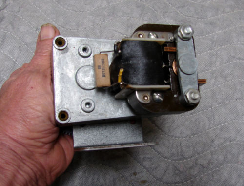

It looks as though that motor has been tinkered with at some point in it's life, as the 2 screws have different nuts on the end. I looked up a picture of that motor and it looks like the nuts should be the same. It would probably benefit me to be on the lookout for a replacement.
In any case, I went ahead and took ALL of the advice given and cleaned up the relay contacts and the motor plug, as well as the plug going into the credit unit. I had cleaned all the plug connections before, but I had never gone into the credit unit prior to today. All shiny now!
I also cleaned the "tracks" on the selector assembly and the plastic where it makes contact. I didn't have any Teflon, so I sprayed a little silicone lube on a cloth and rubbed it over those same areas.
Something worked, as the write-in zipped right along on the next try, with no hesitation or slow spots. I've run it a half dozen times and it looks great. All my fault as I hadn't really taken the time to fully understand the circuit for that motor and hadn't cleaned that relay. I'm learning and having fun, so it's all good :D

It has 4 screws that hold the motor in place. The 2 long screws that go all the way through the gearbox and secure the end plate have nuts on them.

On that brand motor, the same applies to the armature shaft oil procedure, except, I have never had any problem re-aligning that style. "Oil felts" are "slits", "inside", the "nutted" side--you need to look for them--
