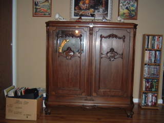

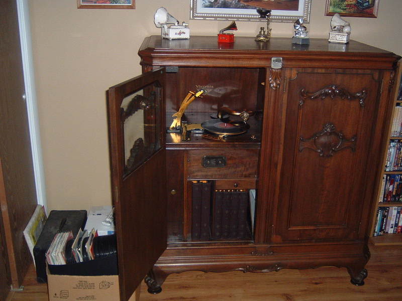

Congrats on owning a 10-50!!! Although space hogs, once you rebuild the Soundbox and seal up the horn, an operatic or classical VE disc fairly blows you out of the room when played on one of these babies! Here is a pic of ours and it has the aftermarket added glass doors and the coin-op feature. I have to say though, I personally never want to move that sucker again!

Aftermarket! Is that what they,re calling machines that have been butchered?
By the way Bill. You should read before posting! The guy doesn't own one. He's asking about them. Or are you just trying to raise your post score :lol:

Hi Bill:
Your 10-50 is truly magnificent! I especially like the "window" in the door panel. I would be pea green jealous of you were it not for the fact that I couldn't get it through my apartment's entrance hallway into the living-room. (Not to mention the fact that I live on the 4th floor in a building without an elevator.) Nor would I be able to play it all that often, what with paper thin walls and floors.

It really is a heck of a piece of furniture. Visitors that have never seen one of these get a kick out of the window, and as long as you leave the door slightly ajar, the light remains on so you can watch the "show."
Collectors do cringe when the record lift ring dumps the played record down the slot though. Needless to say. I don't play real collectible stuff on it but in all honesty it hasn't chipped or broken a record yet.

One thing I've wondered about. I know that the glass panel and coin box was installed for 10-50 customers who wanted to use them for commercial establishments. Along this line, I was told, but have yet to verify, that after the 10-50's production line was established, Victor sales reps. came to the realization that this was a lucrative market, which prompted the "after-market" modifications. In The Victor Data Book, Baumbach states: "Many of these Automatic Orthophonic Victrolas were equipped with coin slots and windows in the front door installed by Victor jobbers. It is possible that Victor offered windowed front doors as an option on late production (or as a retrofit), but they did not offer coin mechanisms on this model." Is he saying that the door modifications were requested by the jobbers and carried out by Victor, or were they done by outside contractors? (I guess it really doesn't matter, at this point, but it would be interesting, nonetheless, to find out.)

Unfortunately, I've been unable to find out very much about who carried out the fitting of the window & coin box mechanism. I will tell you that the machine had to be partially disassembled to incorporate the coin shute and coin box. (you can see the box in the 2nd pic lower right, as the door panel that hid it is tipped to the left.) This particular mechanism has a counter(up to 12), so several nickels could be inserted for more than one selection. Apparently, not all coin op mechanisms had this capability and would only play one at a time. Of course you were at the mercy of what the house loaded up on the magazine spindle! My ser# is 9557, which places it in 1928 range from what I've been able to discern from data that's been compiled by Paul Edie. I too have heard that Victor routed out the wood on the changer door and placed the window there on later machines. At $600.00 a pop, you have wonder how many private homes had these!
