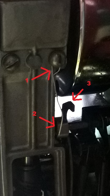

I'm back! Guess what...my jukebox now works. And you might be interested to see what the issue was. I bought all the books and tried all of the obvious things that the books and the good people on this forum and over at KLOV told me to check. Everything looked good. I gave up for a while and moved on to other things while the juke sat collecting dust. I finally decided to hire someone to look at it in the hopes of having it working this past weekend for my son's 3rd birthday party. The whole family would be over and I did not want to answer all of the questions about why my jukebox, which was away for years being restored, still does not work. I got Jeff Statler from Grand American Jukebox to come out and look at it,. We had emailed back and forth and he had offered several suggestions which were similar to what everyone else was suggesting. He was very polite and great at showing me what he was checking and telling me what he was doing. I was extremely happy with his service and would recommend him to anyone. When he removed the right side cover from the mechanism (when looking from the front) he immediately saw something that looked wrong. A second later he was showing me what was keeping the juke from playing records.
So in the picture, #1 is pointing to a wire that is essentially a paper clip. It may not be an actual paper clip, but it is that type of wire. Not very stiff, very bendable. A screw had been loosened and the wire wrapped around it and the screw tightened to hold it in place.
#2 is pointing to the area where the wire was stuck into. It was pushing the nut looking item to the left, so that the item being pointed to in #3 would not fully go down and would keep rejecting the record. The second the wire was moved out of the way, everything worked. Jeff had no idea why the wire was there to begin with.
I am curious if anyone has ever seen this and if there might be some purpose for this wire other than to cause me grief.

The reply that I got when I inquired about the wire was this:
"The paper clip has to be there.... it keeps the safety plunger head from
"sticking" to the chassis....odd that it got bent "out" a little to cause that
problem...."
"After looking at the picture.... looks like a record maybe "caught" that clip and moved it out...
Long part should be closer to the chassis....
then bent in sharply so head of plunger doesn't touch the chassis...."
I am not entirely sure what he is talking about as I don't know what the "plunger head" is, unless it is the thing that the number 2 arrow is pointing to. I would think there is a better way though. Thoughts?

I understand what he was attempting to accomplish--there are other (IMHO, better!) methods of doing this--Yes--the safety plunger is item 2 in your photo. Ron Rich
