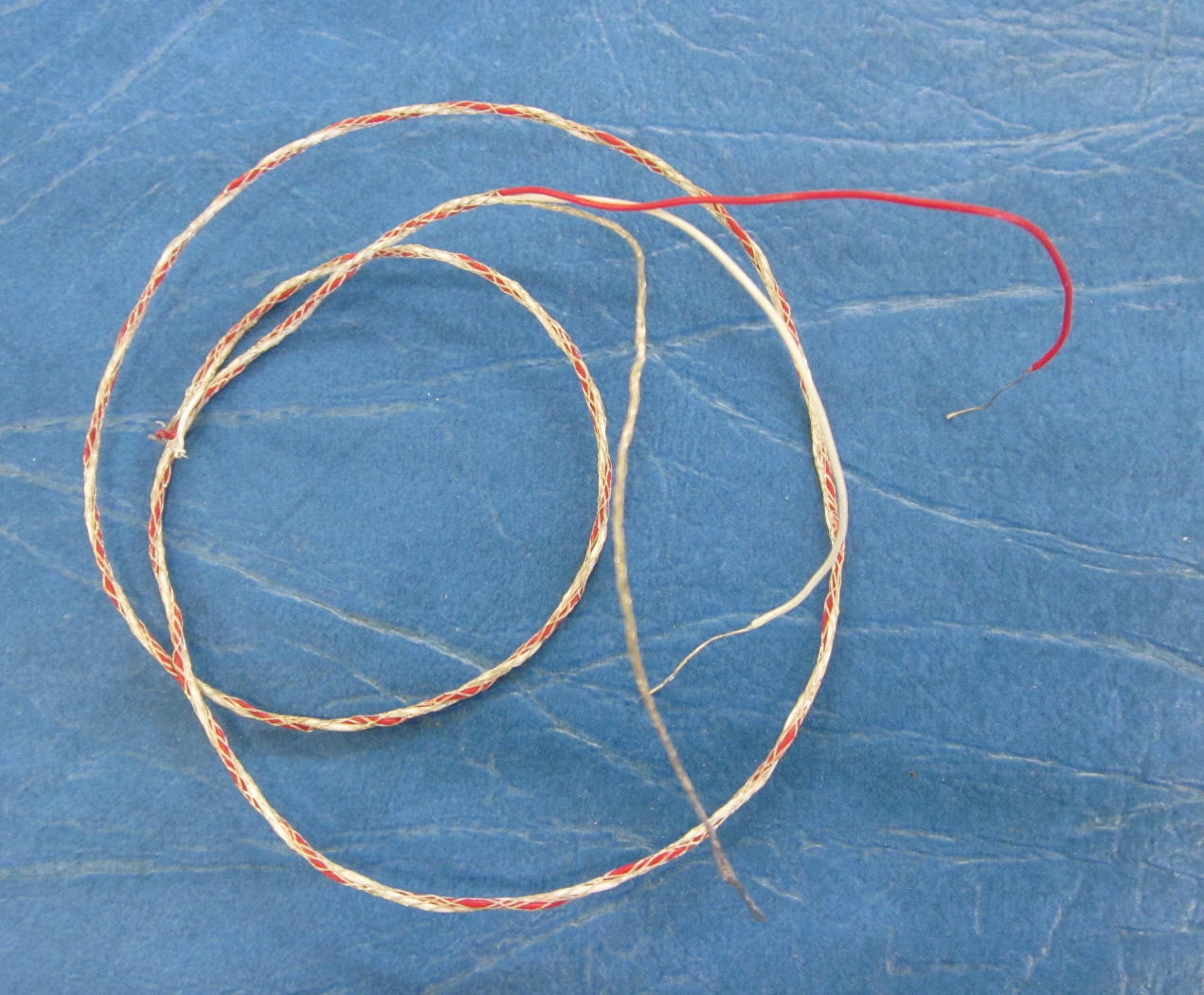

So if I get it right you are talking about a cable that contains 2 twisted insulated wire (probably red - white) and 1 braided shield wire.
My question is if the braided shield shoud be naked or not? Is it covered by the plastic of the cable or is it exposed and touching everywhere?
Does it look like the at
(206.35 KiB) Not downloaded yet
tachment? Cause I can't seem to find a cable with two insulated twisted wires and one insulated braided shield!
Cheers,
Takis
Re: Proper Tone arm wiring in AMI K-200E monophonic
by Ron Rich » Thu Jan 21, 2016 5:09 pm
Hi Takis,
It appears to be the the type of wire I suggested, however, from the photo, I can't tell the thickness--and yes, I use a plastic coated wire--the original AMi wire was not coated, but it appeared to me, that they attempted to insulate it along it's path from all other metal. Ron Rich

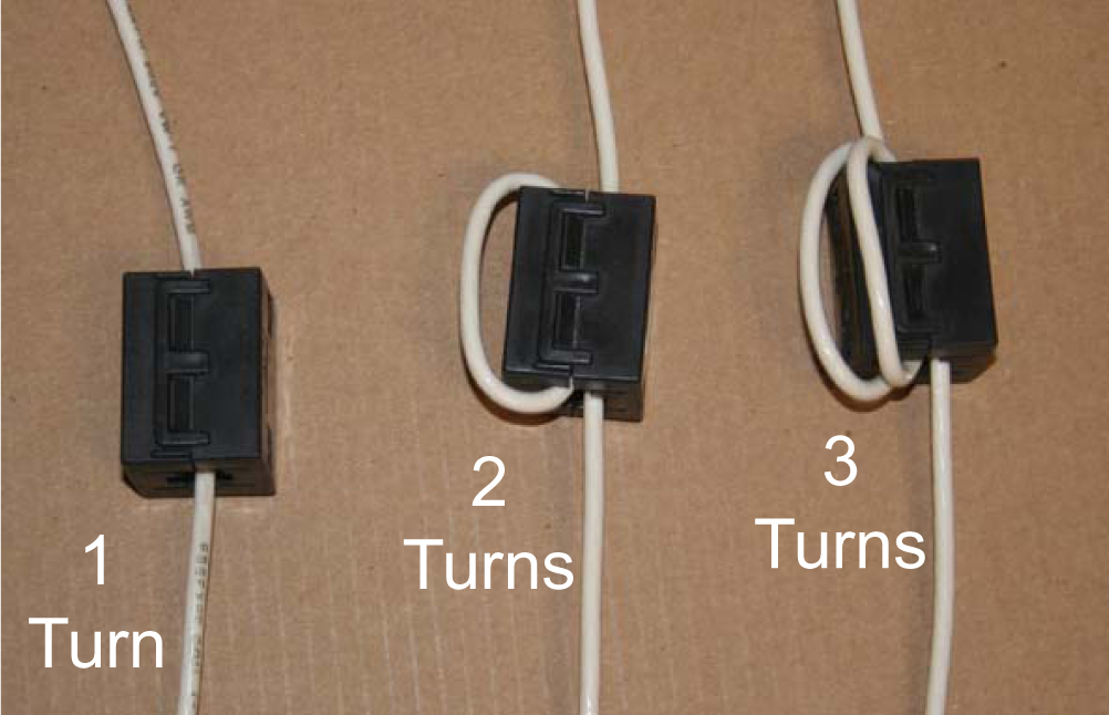

I Did a new wiring. but this time I thought to use a RFI noise filter like this:
Like shown in the version 2.
I don't know why I came to this conclusion. maybe because the cartridge is magnetic I believed this may be a solution. And I did not re-cap the converter (at least yet)...
I was thinking to use a car radio RCA filter, but an electronic expert told be that would only work while connecting the pre-amplifier to the main amp, and would not work on the tone arm wiring.
The weird thing is that what I didi seems to be working! I am making several selections all afternoon and still have not heard the annoying "clicking" sound from the speaker. Maybe it is α coincidence? I'll find out in the following days.

So after some desperate research, I saw this photo somewhere online. It is some sort of noise reduce filter that some AMI model was using in the past. It also looks like it was connected on the RCA input between the tonearm cable and the pre-amp. That's when it hit me to use an EMI noise filter...
Well second day today and still free of "unwanted" noises! I just can't believe it!
Was this a real simple fix? They are very cheap by the way and some people suggest using more than one, although for me it seems enough.
looks true till now :-) Maybe someone else should use it if they have the same problem and give a feedback.
Mine is a mono cartridge and amp.
Oh, and I did mention that i made 1 loop around the ferrite filter, as i read somewhere it's filtering better that way.
