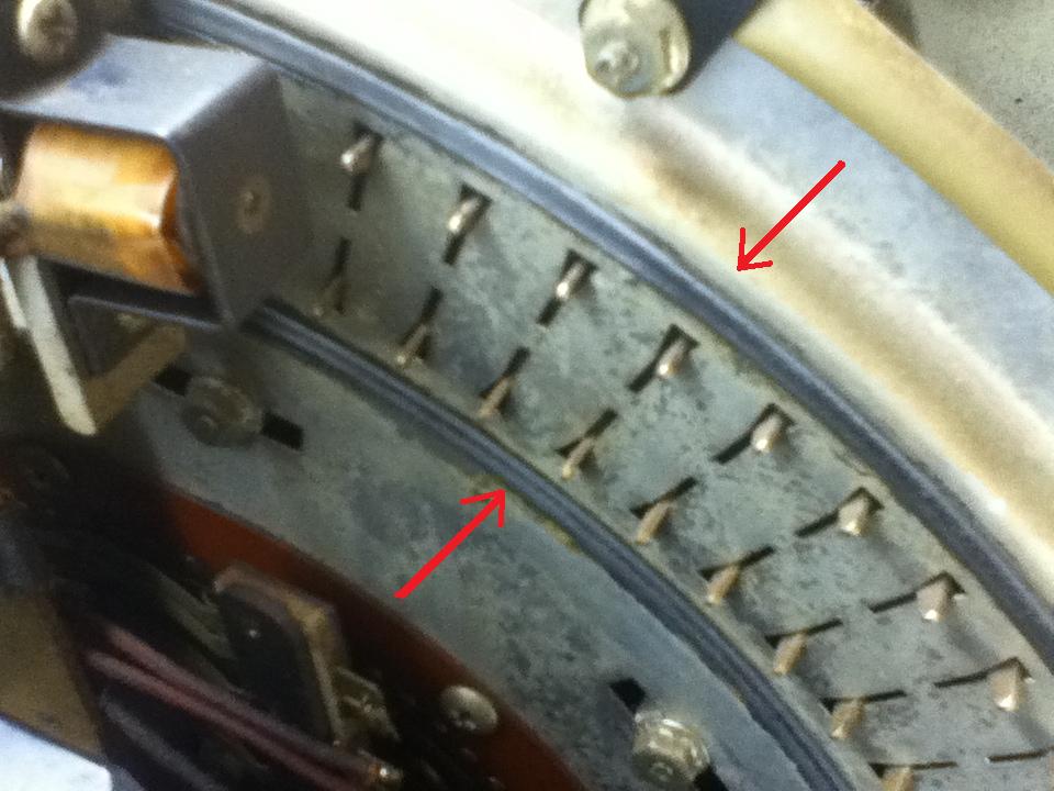

Hi all, I have a Rockola 440 (recently purchased and very new to the game)! Please be patient with me! My question is the spots/rings (one above and one below) the 160 selector levers that the carriage arms rest/rotate on are quite gummed up with grease/residue. What is an acceptable cleaner to clean this grime off with? Once clean, should I lubricate? Thanks for the help. I have a service manual on the way that will hopefully help mw in the future.

The grooves formed by the write in carriage have layers of old hardened grease. I cannot find in the service manual on how to clean this off or how to re-lubricate? Any suggestions?
Notice the lines formed by the write in carriage.
Ipod 2011 214-1.jpg (97.09 KiB) Viewed 671 times

Safety Solvent, and a rag ( or anything else you can put on a rag and wipe).
Zero to an extremely light coat of moly-graph grease. Ron Rich
