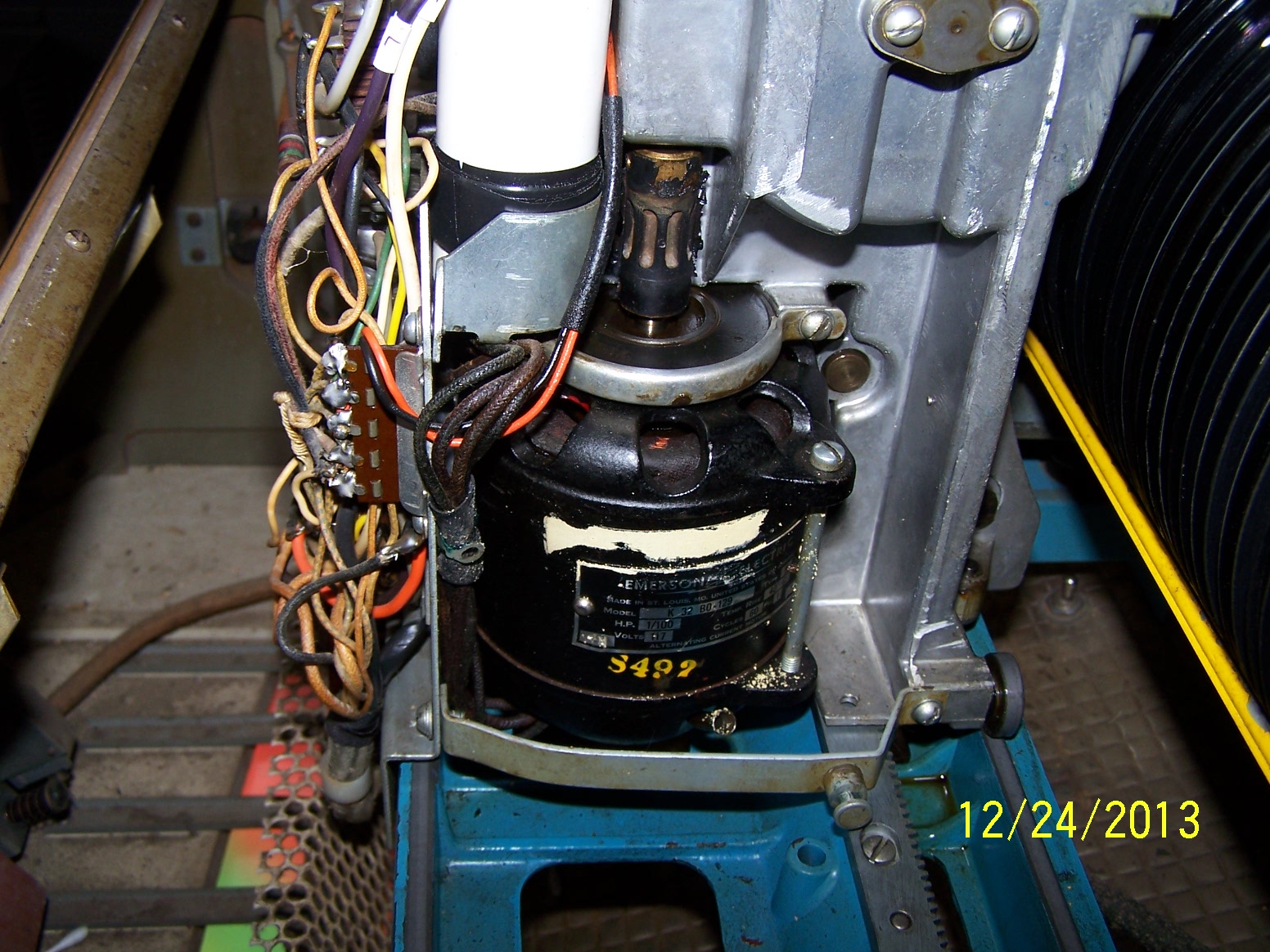

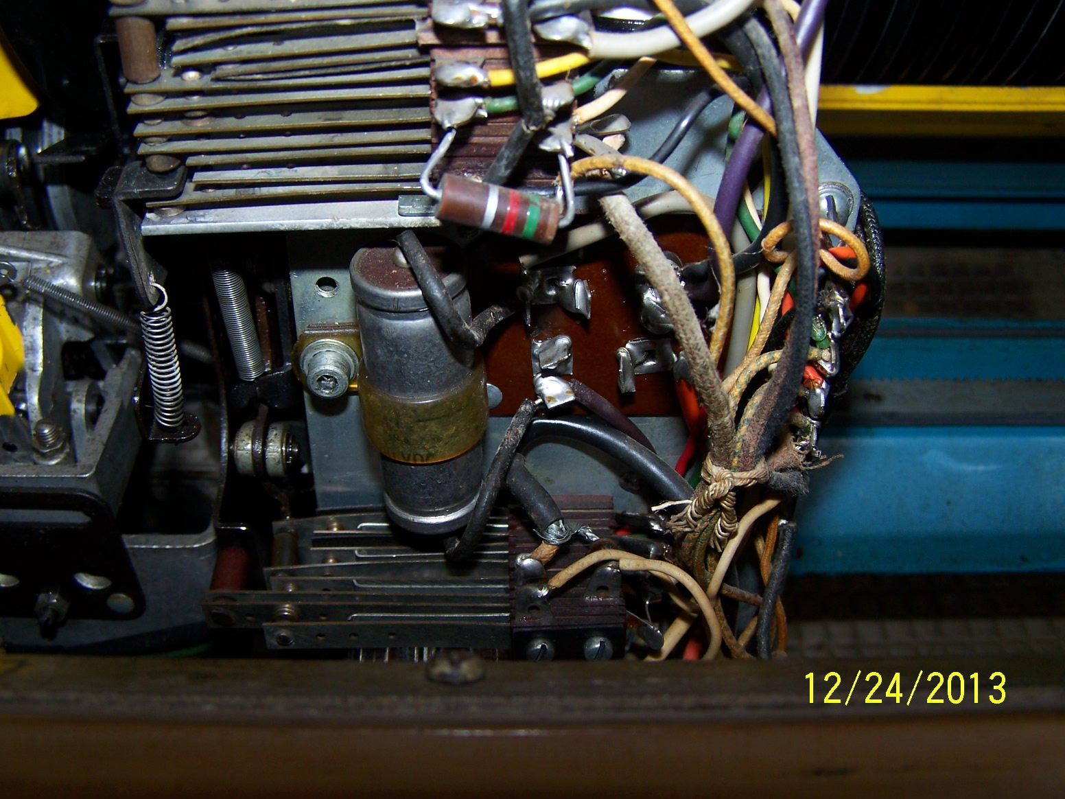

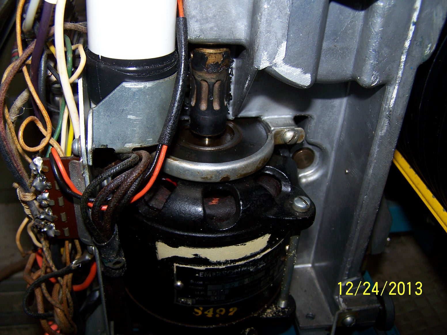

by ultraliter » Tue Dec 24, 2013 7:50 pm
Hi Ron
No oil cups or holes on my motor. Motor is saturated with oil from some previous time. About .002 end play and bearing plate is fine. see pictures of motor terminal board and motor.
Bob
Motor terminal board
(535.12 KiB) Not downloaded yet
Motor upper shaft-No holes or cup
(490.08 KiB) Not downloaded yet
Motor saturated with oil
(457.06 KiB) Not downloaded yet
Re: Record Speed
by Rob-NYC » Tue Dec 24, 2013 8:19 pm
Adding the second cap during play serves no purpose to my mind
The idea was to see if the run cap was weak by adding capacitance -it is called a "test":-)
I agree with the lube idea and if the machine has been sitting idle for a long time the motor mounts and coupling may have formed a memory that shifts slightly when direction changes. However, the fact that the unit reverses readily indicated that this isn't likely a problem.
You say "no EXCESSIVE end play" on the TT shaft-- How much play is there --over 5/1000ths is too much
Personally, I don't see this as a problem. All three of the V-VL's I have in service have end play, one is close to 1/8th inch. It shifts when the clamp closes, after 24 years it has not caused a problem. Since there is no adjustable thrust bearing, I don't worry about it.
In keeping with your suggestion about lubrication, I suggest that the mech be lubed and also, with no record playing feel the mach and see if there is an increase in vibration when the mech is in the "B" play mode. Dry or glazed bearings in the clutch shaft might not cause noise but will cause vibration that can affect speed. That is why I suggested a recording be posted.
