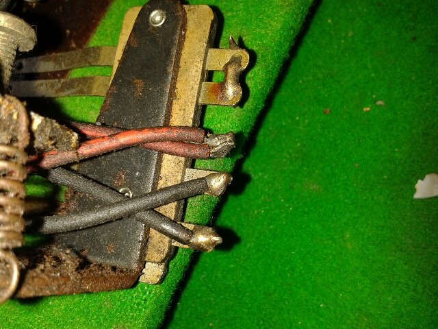

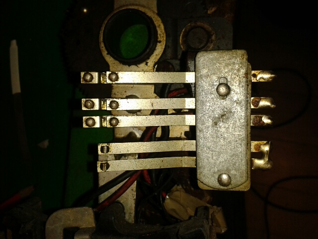

I am still stumped! I think I have cleaned everything well enough and it all seems to be aligned but the write in solenoids are still not firing. Neither of them. Clones, I haven't checked the two relays you mentioned, so I will try to mess with them next. Ron, I am fairly certain the solenoid on the selector is working as it works when I manually select a pin. Just to be sure, could someone take a look at these photos and let me know if everything looks right? Two questions: two of the wipers are soldered together but no wire coming from them. Should they be connected anywhere else? I also have a read out carriage with two solenoids on it as a spare (damaged the carriage), can they be used if its determined mine are both bad?

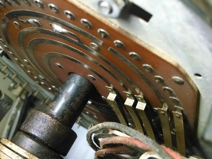

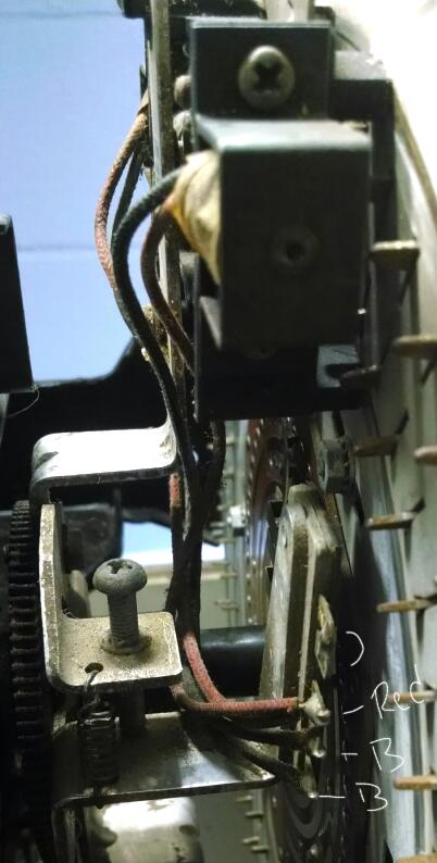

Yes the two wipers are connected together with no wires coming from them, and yes you can use the read out coils, i took a few photos of a write in arm i have as a spare, i still think its a bad plug connection somewhere or something to do with the realys in the credit unit
