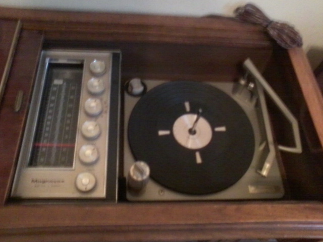

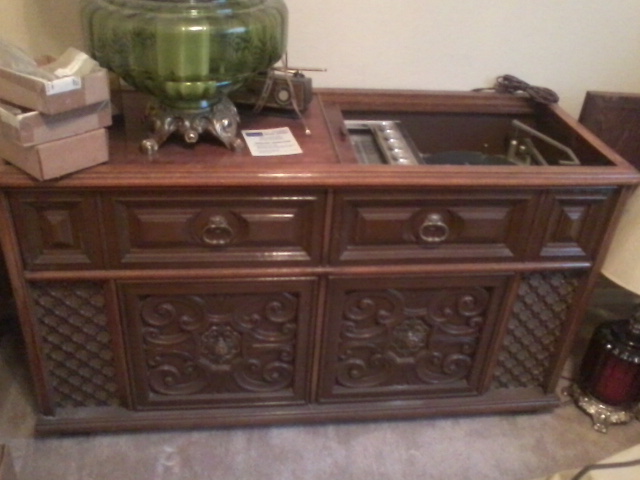

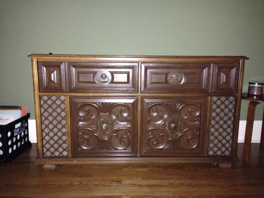

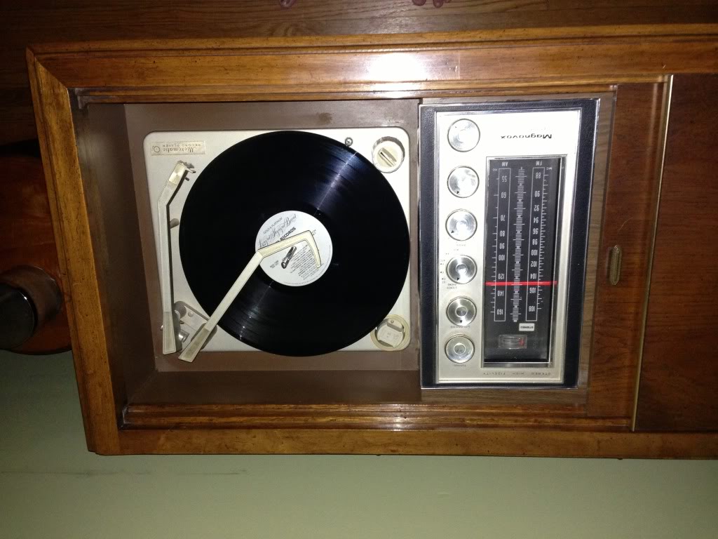

Are you guys tired of seeing another new guy with another late 60's Astro-Sonic?

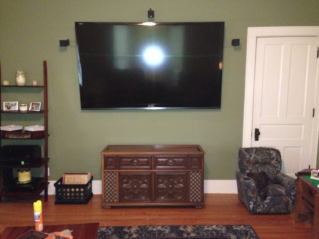

Well too bad - I just got one too. And its my first record player (I'm 32) My wife is 26 and I just got her the Dirty Dancing soundtrack on vinyl and she is quite happy with my new hobby as you will see in the pics below I have a cool wife that enjoys the same furniture I do.
I will include a couple of pictures below.
Of course there is an issue with my new console.
Changer works great!
There is no sound however coming from the right side speaker.
I switched the phono inputs and still only the LEFT side works - so its in the amp I guess?
I know I know... I have read all the threads about take it to a tech - but no more than I have in this thing I will most likely mess with it myself.
Anyhow, I plan to change out some capacitors and maybe some resistors once I figure out the lopsided issue.
I can include more pictures if anyone wants me to but I figure they are all about the same...
Enjoy!
I think my wife likes the 80 more than I do!?!?!
Sorry it rotated on me... Stupid iphone..
