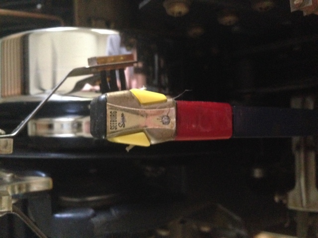

I've actually been meaning to ask if anyone knew which cart I have. I think Ron Rich mentioned it was a later stereo cart. Here is a picture if that helps:
There was an solid state Yamaha stereo amp that had been driving the speakers until I yanked it today for the Mra5. The J2 plug had been cut and was fed directly into the yamaha that was running in Mono mode. With the solid state amp it had very good output, actually too loud for the room if turned all the way up.
The MRA5 will output a fair amount of volume (loud talking level) if set to 25W output and the main volume pot turned all the way up, but no where close to the solid state amp. It's scratchy sounding too... When playback ends it is quiet with only very slight hum.

The cartridge is a Pickering 340D.

The cartridge is not a "340D"--it's a 340--the "D" would indicate "Diamond" needles. It MAY have been a 340-03D, or a standard 340 type, that was modified --can't tell from the photo.
I appears that a "Stereo toe arm" was NOT installed.

1) It looks like that is one of those adapters that allowed the newer (1966-up) cart to be used in older machine arms. Some of those adapters properly connected both coils of the stereo cart in parallel, some used only one channel and other connected them in-series. The last two will result in much more noise and distortion from stylus and record wear begin noticeable.
That cart measures approx 460 ohms/channel. In parallel it will be half. In series it will be double. Measure at the RCA plug.
Those adapter do not add additional weight to account for the cart being lighter than the original so the arm will not balance properly. This causes it to bias toward the center of a record and results in added wear and distortion.
Level: The later cart had much lower output than the original with mono styli. Original cart was around 30mv and the later one is approx 10-12mv. Even with the original cart, the gain structure of the amp did not permit driving it to distortion. That was intentional. As a test, remove the 6SK7 tube while playing a 'quiet" record. If level goes up a lot the squelch contacts in the mechanism may not be making during play. These are the top set on the vertical stack.
The quality and material of the stylus cantilever -does- affect level. NONE of the copy types that I've tested have the same output as the original Pickering made for Seeburg. You might get similar output by using the high-output styli Stanton/Pickering supplied for their 400 series "disco" carts. This will require cutting away most of the plastic to fit the stylus shank into the Seeburg type cart. It still won't equal the original mono cart and styli, but it will sound a lot better than the copy needles.
I measured 473 ohms at the RCA. I tried to measure it by pulling the RCA while it was playing and that was a big mistake. A crazy loud sequel came out of the speakers like a smoke alarm. Yikes.
That means that only one channel is connected. Since there is probably no way of opening whatever was built to adapt that cart to the tonearm you are stuck with a bit more distortion and surface noise if you use this cart.
How did it sound connected to the mag input on a receiver or other amp? If is was good or at least decent considering a likely worn stylus, there is more to be done with that old amp.
Here are the options;
1) New styli for the existing cart. With only one ch connected, it is not ideal. But it is simple and cheap. Some additional weight will be probably be needed to balance that cart properly.
2) Get an original redhead mono cart. Plan on spending at least $100 for the cart and another $80 for the new design styli made in Europe. This will balance and the new styli are stereo compatible though the cart is mono.
3) Change the tonearm to a newer type. The best choice here will be the later type as used in SS160 -end, There are a lot of these around from parted mechs. It is necessary to cut off the tail piece on the "new arm and cut down the existing counterweights to balance the new arm. this will give the best sound and cheapest styli.
4) Change the entire arm-cradle assembly. The only "drop-in" replacement would be one using the "T" needles. These are from 222 to PFEA1U. The assembly will probably cost less than the styli which are specially made for that cart. The sound in mono is decent, but the output is lower than the other options.
You can peruse E-bay and the collector magazines and maybe find one of those "conversion cartridges", But frankly, they are all junk, just repurposed ceramic carts for cheap home stereos.
For home use, option 1 is what I recommend.

I think the stereo to mono adapted cart completely explains the low output when driven by the original amp. The solid state amp had a "mono" button that could double the output to both channels. The sound on that amp was satisfactory and didn't have excessive noise, it just needed new styli. I don't think option 1 is going to cut it for me unless this is still an amp problem. It's surface noise is too much, it's like a poorly tuned radio.

I was able to take apart the adapter. I'm not familiar with the pinout, but shouldn't I be able to bridge both + leads and both - leads to convert this down to mono?
