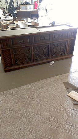

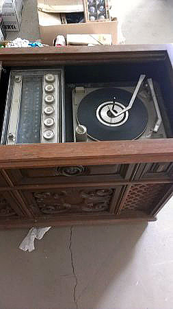

I just got one very similar but larger...same design but one extra panel. It's exactly the same one I grew up with and I was amazed to find this one. The sound is really wonderful, very warm and ... well "BIG" is the best way to describe it. It's almost weird to plug my iPod into the tape inputs in the back! The stylus is broken off the tone arm and I'm looking for a replacement. Thanks for the info here, it should help.
If anyone has any additional information about this one, that would be great. I'm assuming that it must be very similar to the one in this thread, but it just has a lot of record album storage space. These aren't the best pics but you get the idea.
Image Image

by gerryu21220 » Thu Jul 12, 2012 12:25 pm
Needles are readily available on eBay. Just search 557-DS73, and you'll find plenty of them around $6.
Your longer model is a higher grade model, probably late 1967 or early 1968 "500 Series" 50-watt. Likely a model 3813. However, if you compare the control panels, this one appears to be a "100 Series" (1967 and earlier) or "1000 Series" (1968 and later) 100-watt model. Can't locate this specific one with that control panel in the available catalogs.
Gerry
Baltimore, MD
gerryu21220@gmail.com

by dbstevens » Thu Jul 12, 2012 11:05 pm
gerryu21220 wrote:Needles are readily available on eBay. Just search 557-DS73, and you'll find plenty of them around $6.
Thanks! I really appreciate it. You're right, I found info on the back; it's a model 1P3813, pecan finish. It says it's 45 watts. Interesting about the control panel. Maybe it was replaced at some point.
I looks like I need the whole cartridge piece, not just the needle. That part is gone and it's just 4 wires. But I'm sure I can find it.

by gerryu21220 » Fri Jul 13, 2012 7:36 am
Actually, those cartridges are scarce, and quite expensive to buy. Might actually be cheaper to buy a duplicate changer and use the cartridge from it, or just swap changers. Good luck!
BTW: 45 watts listed on the label only refers to A/C power consumption, not audio output.
