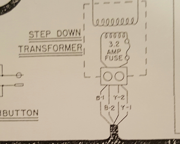

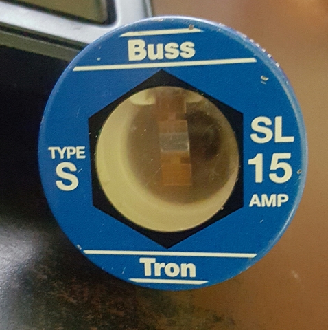

I have a K200 AMI and the transformer schematic calls for 3.2a fuse .Installed is a 15a buss tron fuse that is working But I am wondering if this is dangerous to use it.
Having trouble tracking down the correct 3.2a fuse , any alternatives?

That fuse is only for the wallbox supply. 15Amp is way too much. I replace those old fuse holders with a standard AG types as used elsewhere and 4 amp/slo for my locations. If you have only one wallbox, use a 3 amp/slo.

Rob-NYC wrote:That fuse is only for the wallbox supply. 15Amp is way too much. I replace those old fuse holders with a standard AG types as used elsewhere and 4 amp/slo for my locations. If you have only one wallbox, use a 3 amp/slo.
Here is a pic , the machine wont select a record if this is not inserted , Does anyone know where to find the 3.2a version?
thanks Gregg
