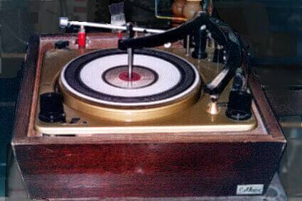

I drilled sockets to hold these tools into the back of my turntable base. You can see them in my avatar (extremely tiny), or the original size here:
http://midimagic.sgc-hosting.com/collo1e.jpg
