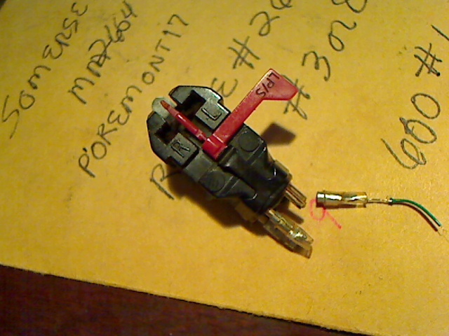

by Bobby Basham » Wed Sep 29, 2010 7:45 am
If you're talking about the connections to the cartridge, those connections pull right off and the wires can be re soldered to them. Some do have a plastic sleeve over them, so you'd want to remove those unless you like the smell of burning plastic and a dirty solder joint. --BB

by netfire_ » Mon Oct 04, 2010 3:37 am
Yes, that is where I'm having the issue, but I can no longer just "pull the connections". The wires have disintegrated along with the plastic shields where the two meet on the clips lol.
Fortunately I MAY be able to solder things back. Keep your fingers crossed for me!

by Bobby Basham » Mon Oct 04, 2010 6:23 am
Well, it looks like you got one of the older record changers like the one pictured on the right, with a taller speed selection switch...they still work great, though. --BB

by netfire_ » Wed Oct 06, 2010 9:05 pm
Found a vintage electronics repair shop. Just got back from dropping off my record player. They are going to do repair it, along with a light rebuild. Looking forward to having it back.
