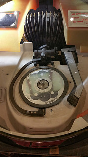

Okay I have a key now , so I can open the front.
I looked at the wiper boards , the one on the right looks clean and the contact brushes seem to be making good contact.
This box was moved and laid down , is there something else I can look for that maybe got bumped out of position?
Here are some pics showing what position it is stuck in.

Re: Ami Continental 2 Jukebox, after move does not play
by Ron Rich » Sun Mar 01, 2015 2:01 am
If "laid down", without taking any pre-cautions, like bolting the components for shipping, you MAY have destroyed that jukebox ?
My suggestion is to locate a "local Pro", that knows that model phono, before you plug it in again. It's "stuck" at least partly, in "play position". Ron Rich
by Rob-NYC » Sun Mar 01, 2015 2:53 pm
Ron, I don't think the machine has been "destroyed"....
"ransome" -It appears that the mech has fully entered play mode. If so it also appears that the tonearm is too far to the right. That indicates that it got jostled out of the cam lobe that guides its action. When that happens the cam will try to move and jam against the cam followers on the arm. Typical of a machine transported on it's back.
First, try lifting the arm assembly right at the rear at the pivot point, if jammed you may feel a bit of resistance in lifting it. Be persistent but don't force. if you get it to rise about an inch or so, turn it leftward so that the pickup is over approx where a record starts. Move it back and forth and see if the arm assembly drops down at the pivot point. If it does it should now be free to follow a record. However it may have jammed just before that point so, carefully apply power and see if the mech now finishes it's cycle and goes into either play mode or returns the gripper over the magazine. Remove power immediately if it doesn't seem to move.
Whether it now cycles or not, it is necessary that the mech be lubed and examined for any further work needed.
--Remove the dome. This comes off by first removing the "bib" under the title board (one screw) with that off, there is a small setscrew that holds the dome's flat tail. Loosen that till the dome can be pulled outward and off -watch out for the dome supports.
--Remove the turntable and the silver screws that fasten the mech cover. Be careful in removing it to not damage the pickup or tonearm wiring.
The gripper motor is an AC motor to the left of the turntable.
About the hum, it would be helpful to those here if you can determine where the hum is coming from. The possibilities are:
--Latch bar solenoid in the keyboard. AMI sort of reversed the normal protocol in that the solenoid is always energized when the machine is on. It only releases when credit is applied.
--Light ballasts. the Continental 2's have 5 ballasts (IIRC).
--Jammed motors. the only likely cause of hum is the AC gripper motor. The small DC one that drives the magazine will blow the Low-DC quickly if it is jammed (if the correct fuse is used).
--Amplifier. This is generally a bad sign that something is either drawing too much power from the power supply, or the filter caps are too old and dried up to work properly. Unplug that amp and don't try to use it again till it has been serviced.
by ransome » Mon Mar 02, 2015 6:24 am
[url][/url]
Rob-NYC wrote:Ron, I don't think the machine has been "destroyed"....
I took your advise and played around with the tone arm assembly. It will pick up the record and put the record away , the turntable is going very slowly. The amp is live and sounding ok.
It is playing every record seemingly in order , How do I clear the memory on this box.
Thanks for taking the time to construct the lengthy response to help me fix this Box , It is getting very close to working I think.
Click on the YouTube link to see a video of how it is working at this point
https://www.youtube.com/watch?v=PyuFZtf-h-A
Thanks Gregg
by Rob-NYC » Mon Mar 02, 2015 9:04 am
Gregg, the T-T proble can be:
-The idler puck is not actually inside the rim of the table.
- The motor mount grommets (rubber) are dried out and have fallen apart allowing the motor to sag and not make contact with the idler.
-The idler puck is totally hardened and can't get traction. Probably not the cause if it was working recently.
- Oil has coated the idler and/or T-T inner rim. Clean with rubbing alcohol.
As for the selections, open the rear doors and look at the large wheel with the pins in it. Each pin represents a record side. When they are punched inward toward the front of the machine the record side that pin represents is selected.
Carefully reach around and press all the pins toward the back of the machine -the non-selected state.
