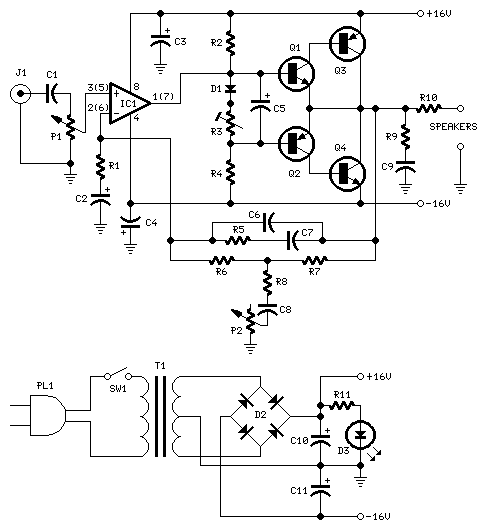

Finally got around to replacing these caps. The originals were 1500uF and 500uF @ 50VDC. Having only 1000uF and 470uF parts, I paired them up and installed them in parallel to replace the 1500uF parts. Then, I tied all the negative leads together to ground as suggested. Powered it up, and...one of the replacements popped and "bled out." Oops. Looking closer at one of the original multi-caps, its triangle lead was labeled "common positive." Makes sense, since the the caps are buffering the positive and negative outputs of a bridge rectifier (see C10 and C11 in the attached diagram for how the parts are used in a sample amplifier circuit.)
Fortunately, I had spares. Installed them correctly this time, and everything's great! Buzzing is gone and the sound is no longer boomy/garbly. Really smooth, big frequency response. She sounds as good as she looks. :)
Thanks for the advice, everyone!
Sample audio amplifier circuit. C10 and C11 are the capacitor parts I replaced.
