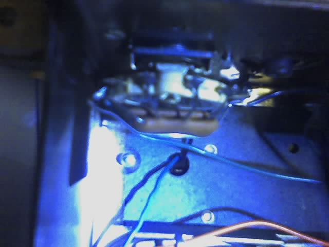

Okay, sorry for the misuse of terminology. So, we're talking about some type of "rotary" pot. I tried to take a pic on my cellphone so you can see the underside with a wide, horizontal open slot just above that shiny solder connection in the center of the pic. That's where you would spray the Deoxit. This is just a control on a Maggie chassis.--BB
