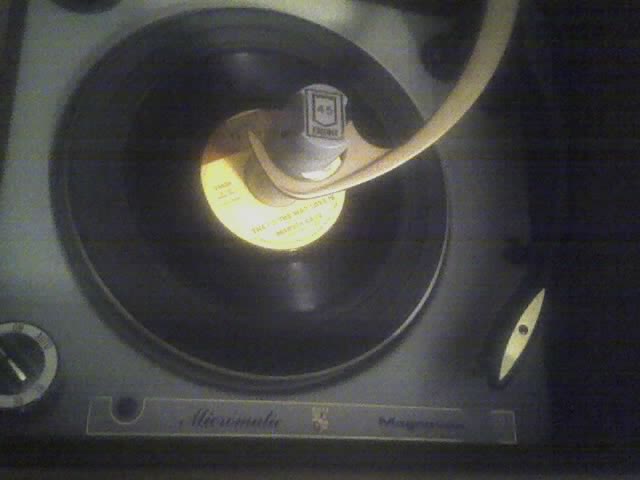

Does any one have any tips on getting the Magnavox spindles to perform any better? The one I have seems to have the metal tab/45 support will hang
and not retract and let the next 45 drop. Has any one dealt with this problem before?

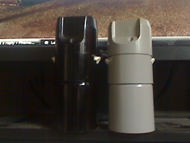

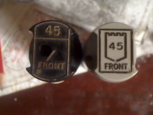

Oh crap, I can't see very well from the dark pic, but would that be one with the hole in the top that can hold about a dozen records and the spindle is really tall, partially protruding through the top, or is it just a black version of the popular ivory colored one? That is something that would fit on one of the older micromatics with the black curved tonearm i.e., W602 - W608 series. --BB
This short, plastic adapter works with the W714-W716 series turntables found in 70's units, as pictured below. You can only load about 4-6 LP's max on that short spindle.

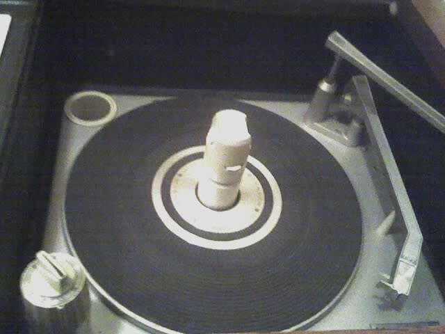

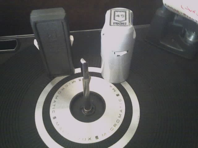

The flat, rectangular one on the left came with my W802 series turntable which looks exactly like a W620 but has square corners, but the more popular one on the right will also work and it was used on the W602-W608, W620-W622 series. The newer W700 -W800 series used a single idler wheel for speed and change cycles and had those brackets where you could turn 90 degrees and lift the turntable directly out instead of removing the back panel.

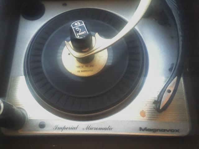

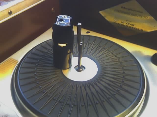

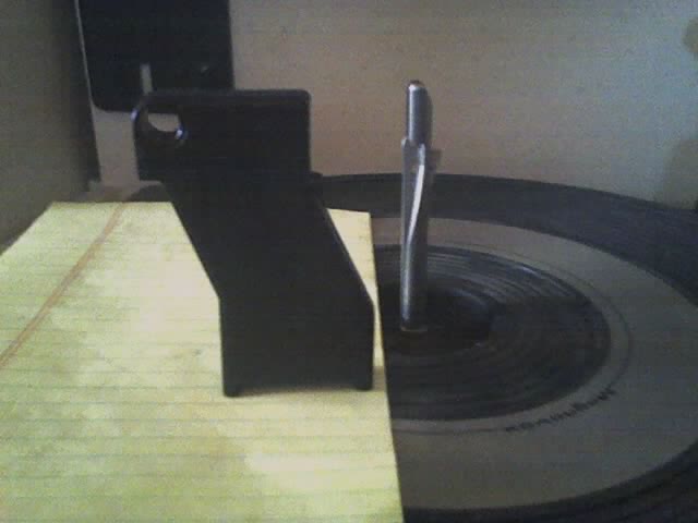

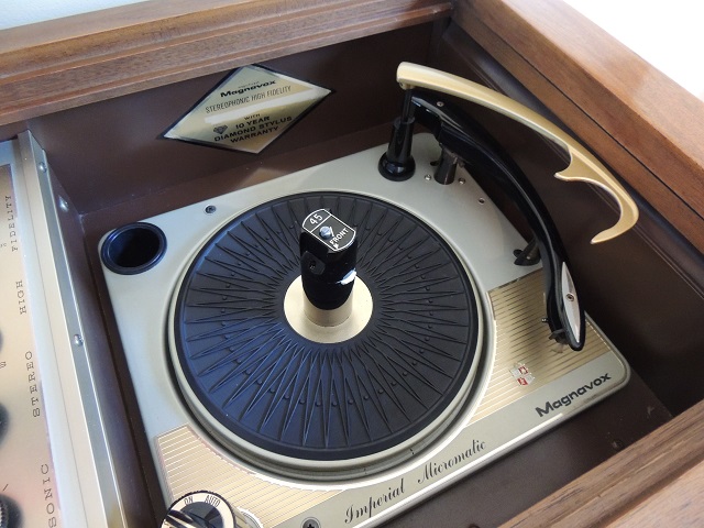

No expert here by any means, but I have two identical turntables, the one with the taller spindle protruding through the top is labeled "Imperial" micromatic, while the other is just labeled micromatic and has a shorter spindle.
The metal tabs on the black one are slightly higher than the other and is about a quarter inch taller. I don't know what turntable you have, but you could possibly have the wrong one and the works inside are not aligning with your particular spindle. I did swap the adapters to see how they'd work, and that black one sorta "semi" worked, but the fit wasn't quite right.
Please note the different shapes of the two spindles in the last two pics, particularly the tall older style where it is offset to the left and then up, while the newer ones go straight up. --BB

here's what I have, and again what it does is when I put 3 or 4 45's it will drop the first one and then none of the rest. I tried mixing up the records to
see if it was just one 45 hanging up but it didn't matter what record was next....same problem.
