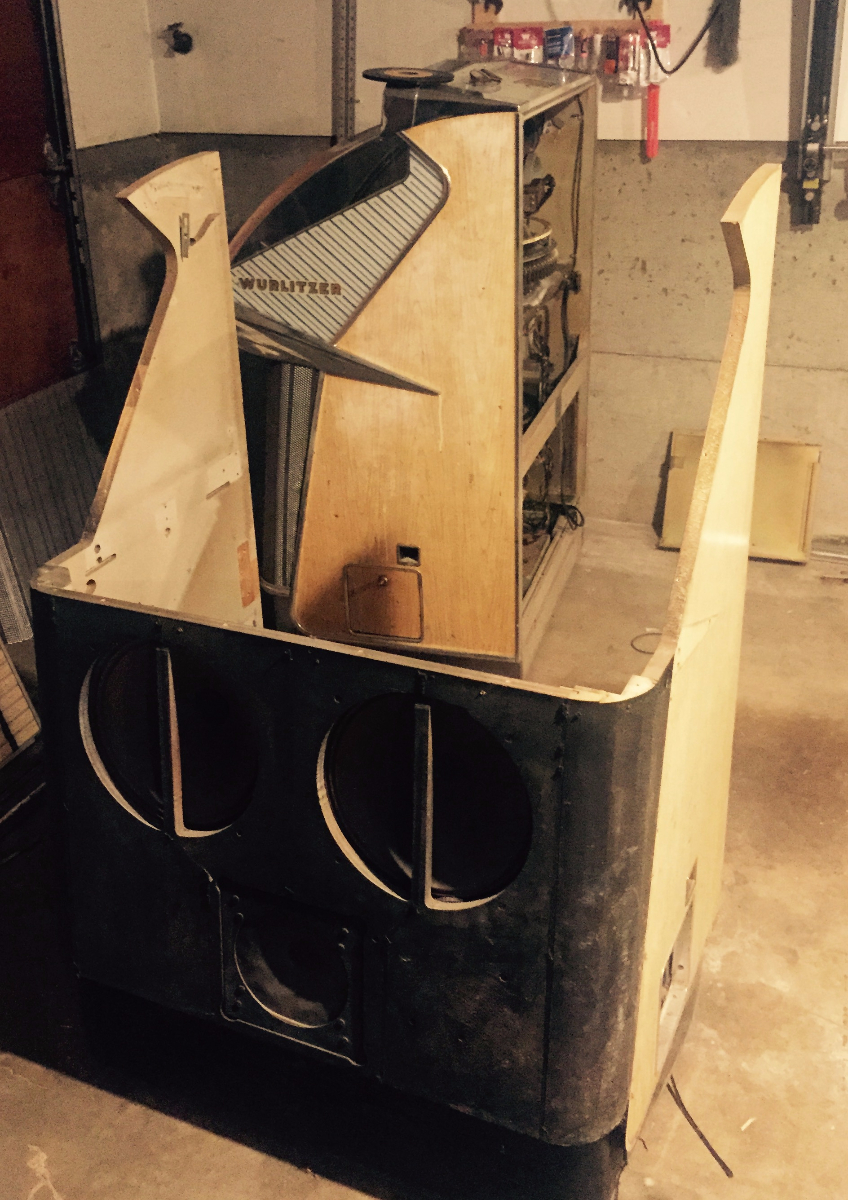

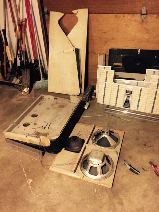

I've managed to strip most everything out of the cabinet as well as remove all of the various pieces of cabinet trim. The disassembly was pretty easy and fortunately no stuck or stripped screws and it's going to be quite a luxury to have the parts machine next to it for reference when it comes time for reassembly. Next step is to take the cabinet apart and re-veneer the sides. A couple of questions:
The speakers look to be in good shape with no tears in the cones or anything obvious that I can see. However, it looks like the only way they can be removed is with most everything removed so should I have these speakers checked out while the cab is empty? Do speakers wear out?
Last question is unrelated but I placed an order for a book from alwaysjukin. The amount was debited from my account 11 days ago and I received an invoice but no tracking number. I emailed and never heard back as well as called but the answering service said the box was full. Is this typically how it goes. I know it's a part time gig for the owner.

J-C, your speakers are probably fine. I have eight old Seeburgs (V-Vl_K-201) out with original speakers you want to test them just connect them to a typical amp and listen. Use moderate volume as these do not have high power capability.
A slightly more revealing test is to connect a 3-5 volt AC supply from a 60hz line. This will show any rattles.
The best test uses an amp and signal generator to sweep from bass approx 50hz (don't go lower on those speakers) up to about 600Hz. This will easily reveal any rattles or rubbing voice coil noise.
I find it best to check the speakers when bolted into the cabinet. The reason is that slight warpage of the baffle board might in-turn shift the speaker frame and cause a rubbing voice coil. One of the speakers Wurlitzer is particularly susceptible to warp damage. That one has a particularly small voice coil with tight clearance. IIRC that one is on the left as viewed from rear.
As for removing the speakers, if you remove the title board and rear doors and contort yourself a bit, they can be removed w/out taking the mech out.
Seeing the stripped cabinet reminds me of how flimsy that model was. An old op used to say that "they do a little dance when moved". Still, that series and the 1800 were my favorites of the Wurlitzers.

As Rob said--your speakers are most likely just fine--If properly constructed, and properly matched to the amplifier, speakers should last "forever" ! Most jukebox makers ( the "big 4", at least) took great pains to do the above AND match their speakers to the cabinets. As for "contorting" oneself, to remove those speakers--I don't think there ever was a time in my life that I could do that !! :lol:

Good info fellas. Now that the cab is apart I got a god look at the speakers and they seem fine. No tears or any damage to the cones.
The cab came apart fairly easy. The sides were screwed in place but the front of the sides is screwed and glued to the corner pieces and tongue and grooved. I separated that with some careful tapping with a hammer and chisel.

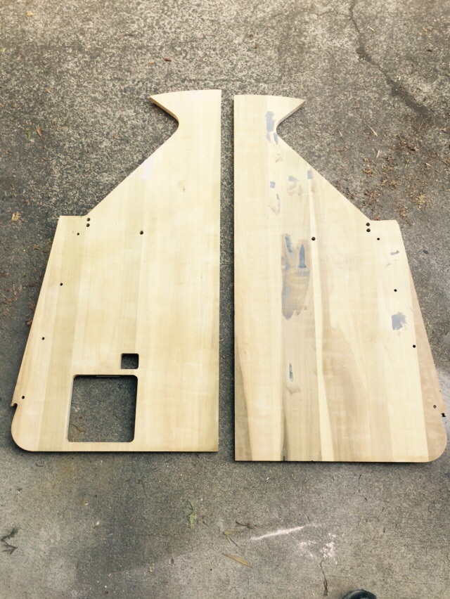

It took about an hour per side to remove the old veneer and then sand off the last remnants to get a smooth surface. Despite the original veneer glue being almost 60 yrs old, it was still very strong. I then applied the 3mm baltic birch veneer, let that glue cure for a day, and then routed the excess off. Of course after I had put away all my tools I realized that I forgot to rout the coin return and coin box openings.
The pic shows the sides with the veneer removed and with epoxy filler in the divots and the other pic shows the new birch but it's not been sanded or finished yet. Not sure what type of finish I'll be doing.

Yeah those pics aren't great. Once I get all the holes routed and the finish applied I'll post some better pics of the finished sides.

pic of the sides with front corner pieces attached and are now pretty much done. in about a week the finish will be fully cured and they'll get a coat of paste wax to bring out a very slight sheen. the inside of the walls as well as the base and front/rear of front wall have all been painted. next step is to reassemble the cab and attach all the metal trim pieces. once that's done i can start replacing all the interior components as I go through each sub-assembly.
