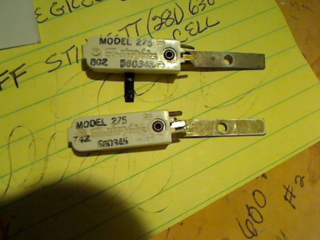

You're on the right track as far as cartridge numbers. There may be an addtional number on the back of it. I have a sample of an EV275 with a Magnavox 560345 number on it. I don't know with the 802 and 742 designate.

On the cart.'s added numbers--it is a "custom" that when one company uses a pre-existing part ( or has one built to specs.) made by another company and adds their own "in house" part number, that a "date code" is added at the time of delivery (and hopefully "incoming" QC inspection). If it's a three number code such as this, it is usually read as the year-and week number. Thus "742" would indicate the 7th year ( of the 50's, or 60's?) and 42 would indicate the 42nd week of that year. "802" would be the 8th year, 2nd week. If the product is used past ten years, often the code gets switched so that it would designate the week first, and the year last. Thus "742" would now read "427" for the 42nd week of the seventh(eenth) year--- Ron Rich

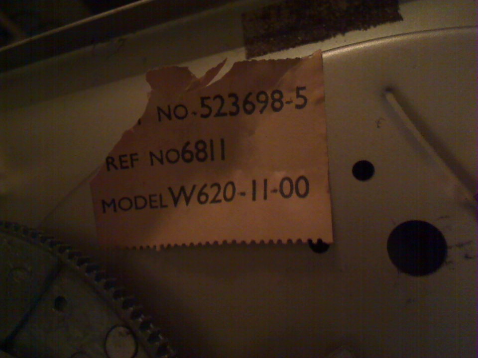

Regarding that "3rd" number/in-house part number. I was totally clueless. No tech here, just playing it by ear. There must be more on that cartrdige other than "426", unless he has an older model that may only have one number.
Picture 32.jpg (95.88 KiB) Viewed 6542 times

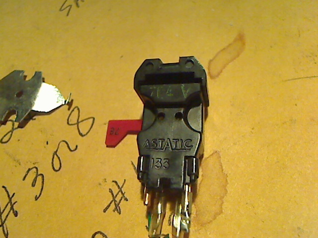

I'm thinking he has a unit from between 1966 and 1968. He needs to look at the underside of the turntable to see exactly what he has...Maybe a W620/W621/W622 turntable. In that case, he may have the small EV275 or an Astatic 165D, very little, if no, difference. Just remove the single screw that holds that mounting bracket to see what other numbers may be hidden.
Picture 8.jpg (95.99 KiB) Viewed 6542 times
If Radio Shack still has them online, they were between $4.99 and $5.99 years ago.

There are only two basic "275" style cartridges.
One produced 160 mv, the other 250 mv output.
It's got nothing to do with bass or treble though.
It depends on the input circuitry of the individual unit its used in.
