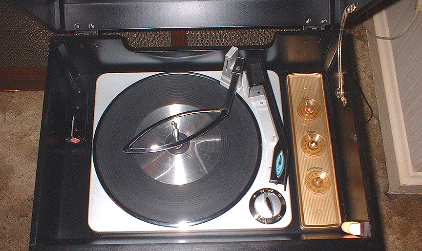

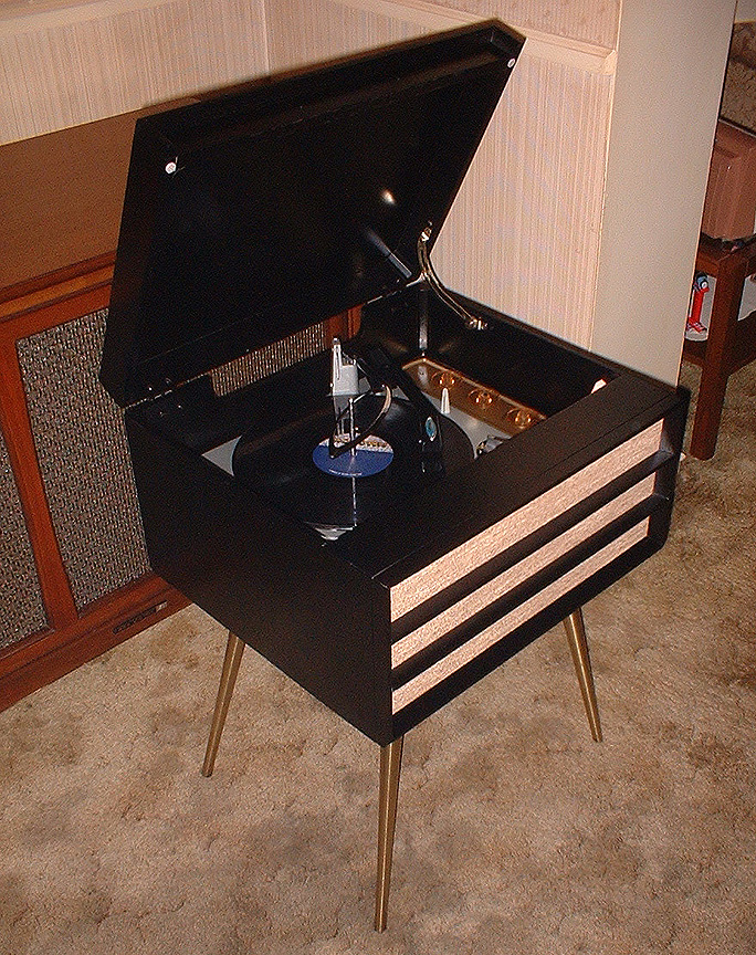

My SHF-12 - I did a complete restore/repaint/customize on it, makes a nice bedroom player - perfect to go to sleep to.

Very nice Matt. I have a similar unit, stereo with extension speaker, with the off white tonearm. I like the style of yours better

Yeah, it came out nice.
I dropped in the RP-217 style "studiomatic" changer as an upgrade.

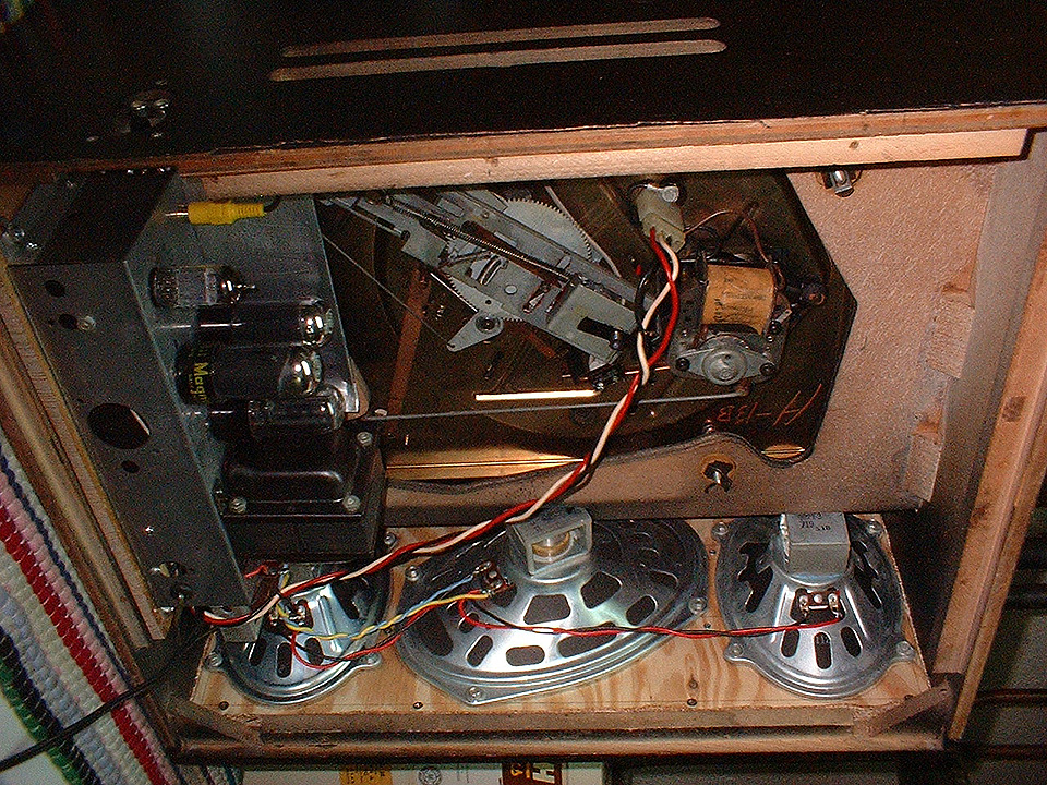

Also custom built a PushPull 6V6 AMP, and used a 3 speaker setup - the thing kicks ass.
Satin black for the cabinet, new grille cloth, and a customer offered me the brass toned legs.
So now I have a one-of-a-kind freak consolette!
