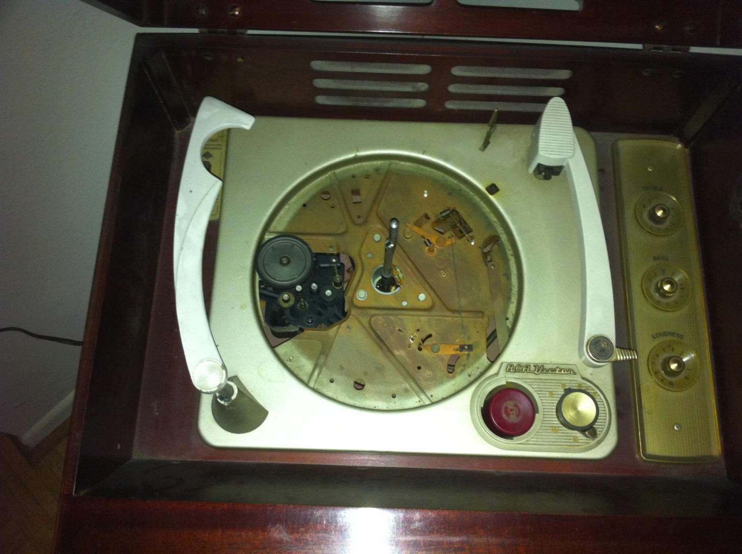

Hello,
I have an RCA Orthophonic High Fidelity that I believe is a 1957. Model #SHF-8.
The problem I am having is that the turntable is not spinning strong enough to turn the record. Essentially, it is slipping. You can get it to spin just enough to know its working by moving the speed control to exactly the right position, but unless you are on 78 speed, it doesn't play.

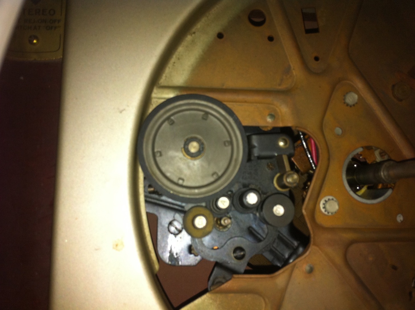

I removed the turntable and found that the motor appears to be spinning strongly. As I move the speed control it is properly moving between the different speeds, but when engaged the wheel that spins the turntable seems to slip. Since this parts are made of rubber and plastic I assume it is common that they might wear out, so hoping someone here can give some ideas on resolving this issue.
See photos.
- midster

Clean the rubber parts with alcohol or rubber rejuvinator and the inside rim of the platter. Make sure the parts spin freely and oil them if necessary but use only one drop of light machine oil such as sewing machine oil and DO NOT get any on the rubber. I have a 1958 stereo version of this, a PD-24. The tone is quite nice.

Unfortunately someone had already adjusted the spring, so its already not calibrated properly. After looking closer I can tell the problem definitely appears to be slippage in the idler.
Aside from having the parts re-furbished. Anyone know where I can buy replacements?
midster
Posts: 5
Joined: Mon Jan 03, 2011 2:05 am
Re: Orthophonic High Fidelity Speed Issue
by midster » Sun Jan 09, 2011 7:31 am
BTW.. while I have found some places that will re-furbish the idler, I have had no success finding anything about refurbishing or replacing the capstan. I believe this is where most of the slip occurs because when I lightly touch the top of one of those wheels, it immediately stops.

One of your difficulties in locating a source, is that they are not generally referred to as "capstans", but as "turrets".

The turrets, (33/45/78 rpm) along with the idler wheel, are available at Gary Stork's Voice of Music website.
The turrets simply snap off.
Replacing with a new one, a drop of oil on the spindle it sits on is needed..... just a drop.
