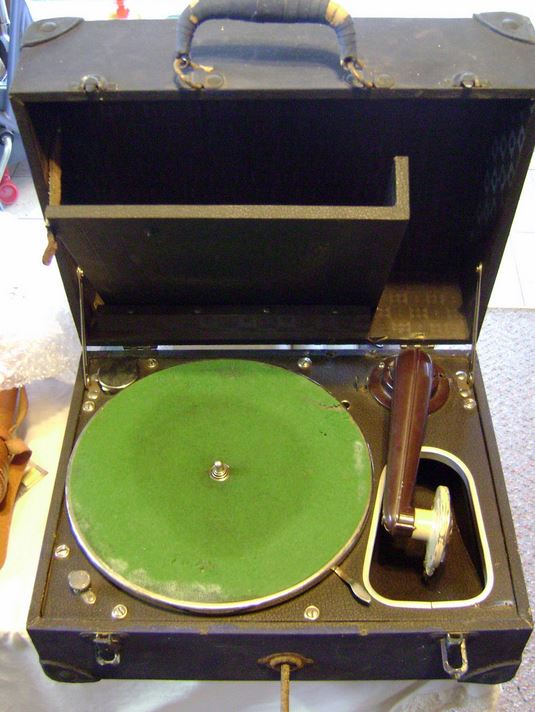

I bought a silvertone phonograph off eBay and I knew there was troubles with it but there is no sound barely coming out reproducer is a orthophonic era I'm guessing this machine is from 1926 somewhere around that era please let me know what some issues could be thanks

Is this the one you got?
http://www.ebay.com/itm/Silvertone-Mast ... 7675.l2557
Silvertone One.JPG (69.05 KiB) Viewed 1848 times

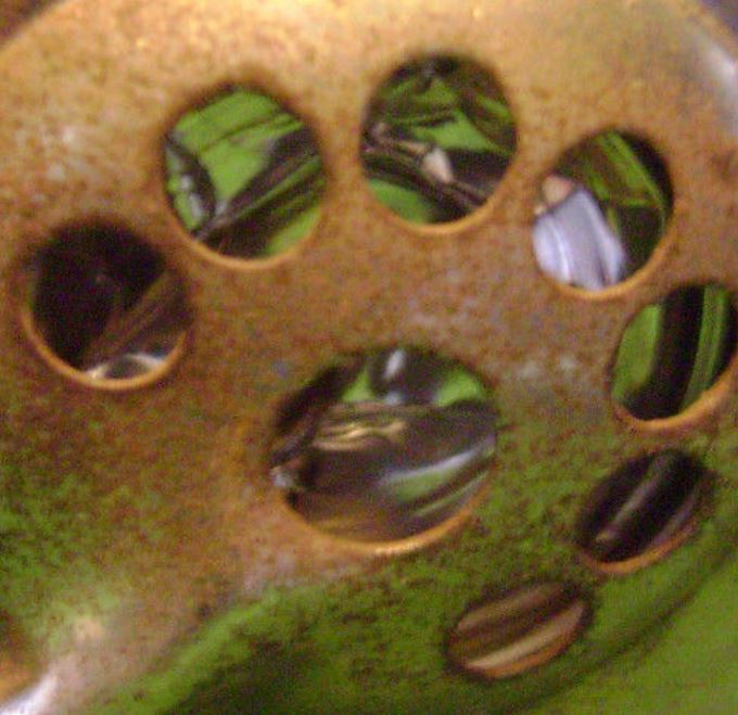

If that's the case, then the tonearm and sound box are not original to this model. They look to be from kiddie phonographs produced in the late 1940s/early 1950s. Also, the sound box's diaphragm appears to be damaged, which would account for the poor volume:
JDS

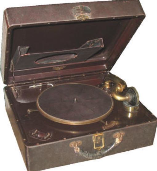

Here's a photo, culled from a youtube video, showing what the original tonearm should look like --
Silvertone Tonearm.JPG (41.51 KiB) Viewed 1807 times

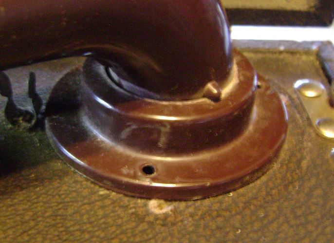

If you look carefully at the base of the tonearm fitted to the one you have, you'll see that the screws don't line up with the original holes --
tonearm base.JPG (59.22 KiB) Viewed 1807 times
I used to have that same, exact model, which was from about 1927. The reproducer, or sound box, which was about the size of a Victor #4 sound box, was fitted with a mica diaphragm. It actually sounded pretty good, once restored, but because of the short horn, didn't have much of a range, compared to the more deluxe models that were fitted with correctly shaped exponential horns that circled around the turntable, exiting at the back of the machine, such as this one:
(I've been looking for an all original version of the model you have to show you what it should look like, but none appears online at this time.)

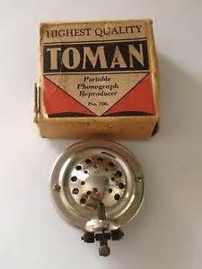

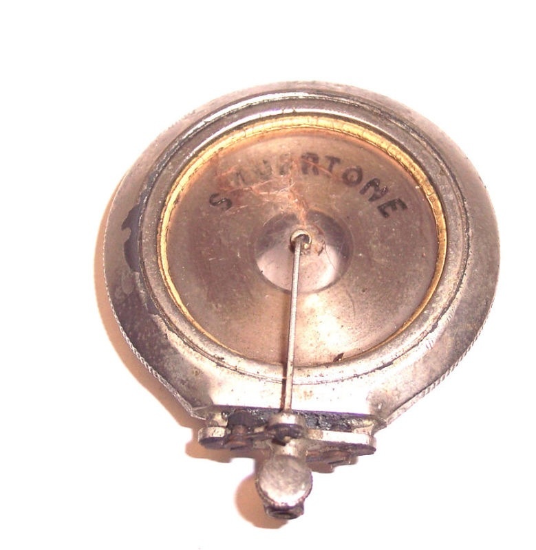

I found a similar reproducer looks Like the one you sent me idk for sure though looks close but not sure ?
Re: Silvertone phonograph master barely no noise coming out
by Joe_DS » Mon Dec 02, 2013 7:55 pm
That sound box is most often found on the Silvertone cabinet models sold by Sears, starting in the early teens, through about 1925. It may or may not fit the tonearm of your machine, and was definitely not designed for playing electrically recorded, later period 78s. It does do a pretty good job playing acoustically recorded records, however.
The one that came with my portable had a larger mica diaphragm and different style needle-bar pivot that was more flexible. I haven't seen anything similar online.
If the sound box you have cannot be repaired, I'd suggest you look for something similar, with an aluminum diaphragm, etc. That would be the easiest on your rock-n-roll 78s, providing it's in optimum, restored condition.
But, as a final word on my part, I still think it would be better to recoup your loses by putting that one up for sale, say on craigslist for about what you paid for it, and tracking down something a little better.

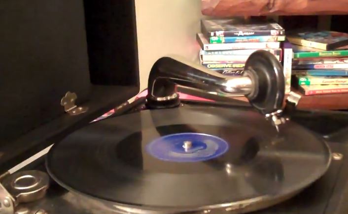

Along this line, I spotted this very nice Silvertone portable, from the late 1940s, that would probably do a good job --
http://www.ebay.com/itm/VINTAGE-RARE-Se ... 2c77bec421
Most likely, the sound box could use an overhaul, but it sounded pretty good in the video, though I wish he'd have played a more conventional record, such as a dance number, or whatever.
