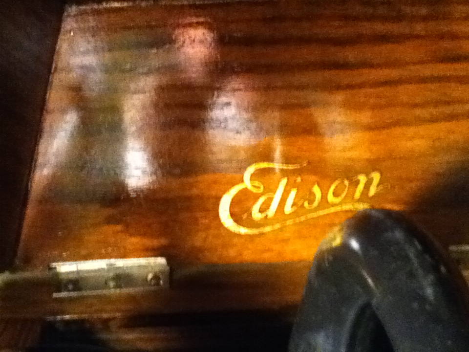

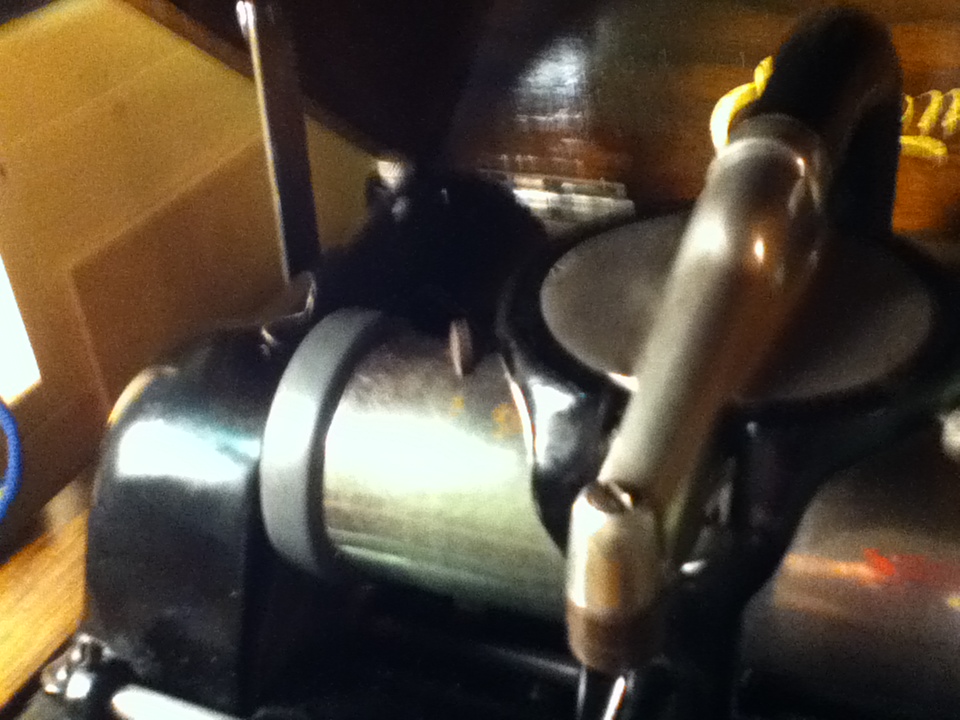

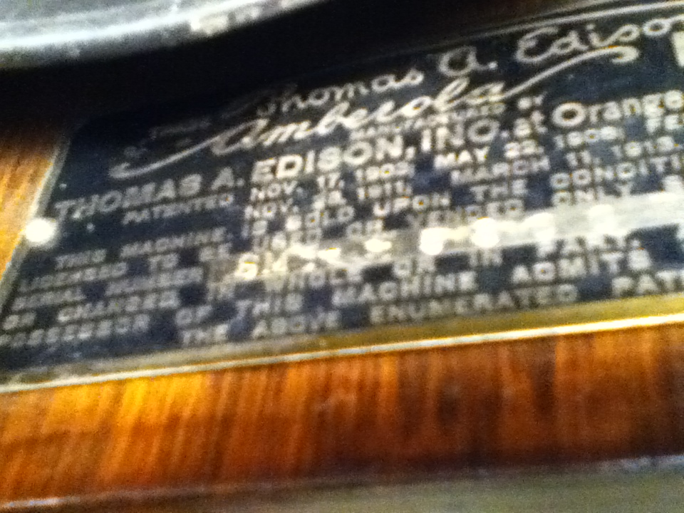

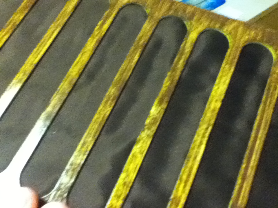

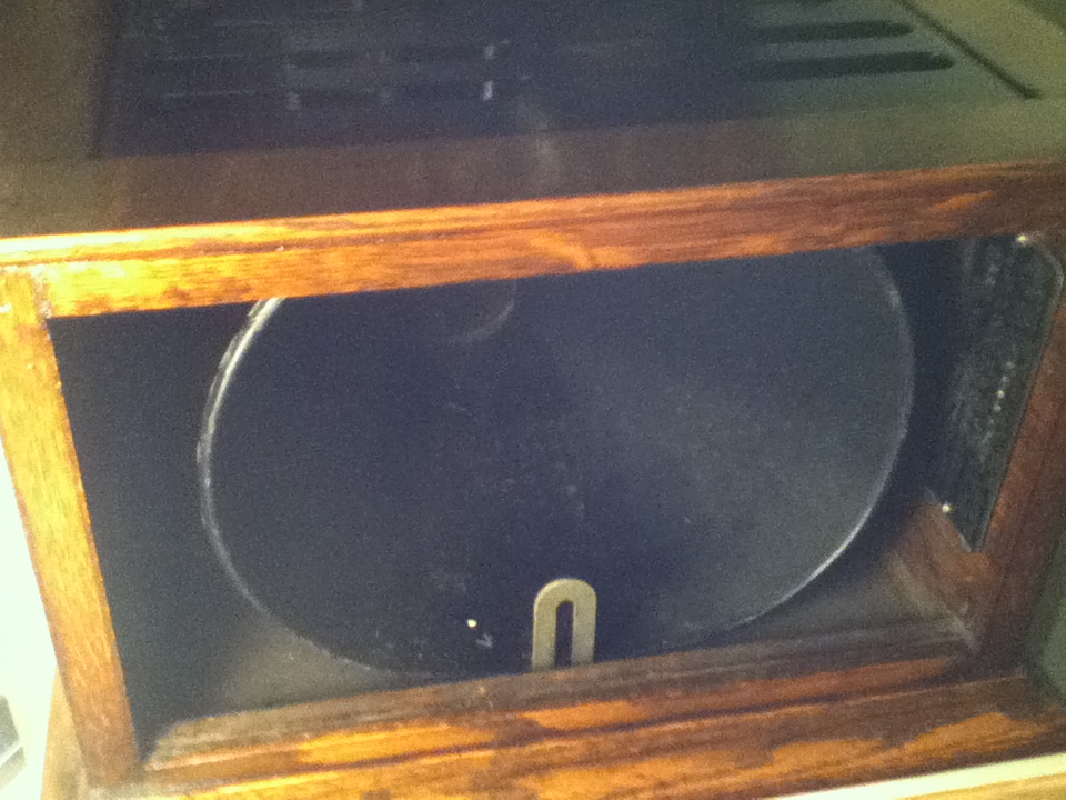

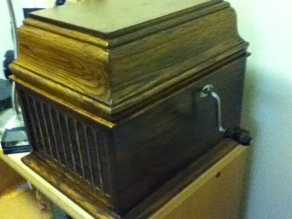

I got this just in time for college. Boy, it sure is the perfect size for a dorm room! At first (after getting into disc machines), I shied away from the late Amberola series, especially the 30, as I figured they would play poorly and, with such a small horn, the 30 would be quiet. I was very wrong! My Amberol 30 plays very well and (when the grill is off) disturbingly loud for its size. The grill cloth muffles it a bit so it plays at a much more reasonable volume now. The reproducer has not been rebuilt so it blasts on louder cylinders a bit, but is perfect on lower volume cylinders. Anyhoo, it is the earlier model with the fancier lid, nickle reproducer, external speed control, and the grill is wood-grained.
I do have a question though: The stylus picks up a noticeable amount of dust after every play. However, I can see no lines being left in the run-ou/in areas (even under strong light), and the grooves don't appear to be wearing any either. Do you think the stylus is bad?
I find this odd, as I've expereinced bad stylii on my Diamond Disc machine and the symptoms were quite obvious. I'm going to rebuild the reproducer with fresh gaskets and decide between a couple of well knowm modern diaphragms. This should increase compliance a good deal. Perhaps it is a lack of complience that is causing the dust?
