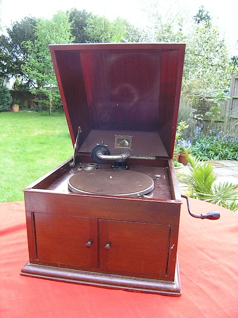

I can answer your first question. The HMV 103 was, indeed, designed to play the recently (1925) introduced electrically recorded records. If all original, it should be equipped with a #4 sound box (reproducer), a thin swan-neck style tonearm, and a long, tapering horn inside the cabinet.
Here's a nice photo of an HMV 103 --

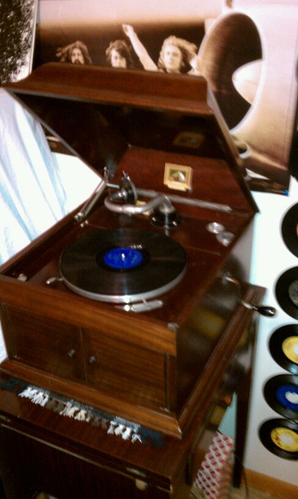

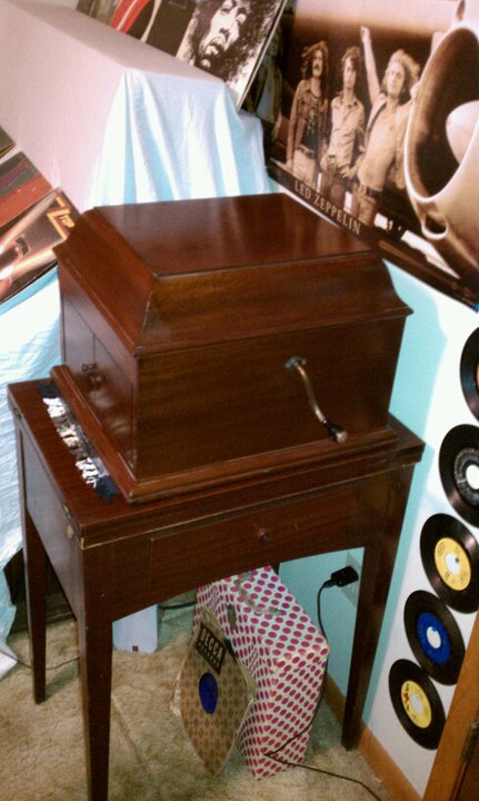

heres some pics of the hmv 103 i got!!
my hmv2.jpg (69.82 KiB) Viewed 3304 times
Re: HMV 103 from 1927
by Joe_DS » Wed Jun 23, 2010 6:01 am
Nice looking gramophone! If the plating is dull, but otherwise without signs of corrosion, I think I'd leave it as-is, at least for the time being. I believe that they used nickel plating on the metal parts, but whether a protective lacquer coat was applied over the plating, I don't know. Hopefully, we'll hear from some of the UK based gramophone experts.
