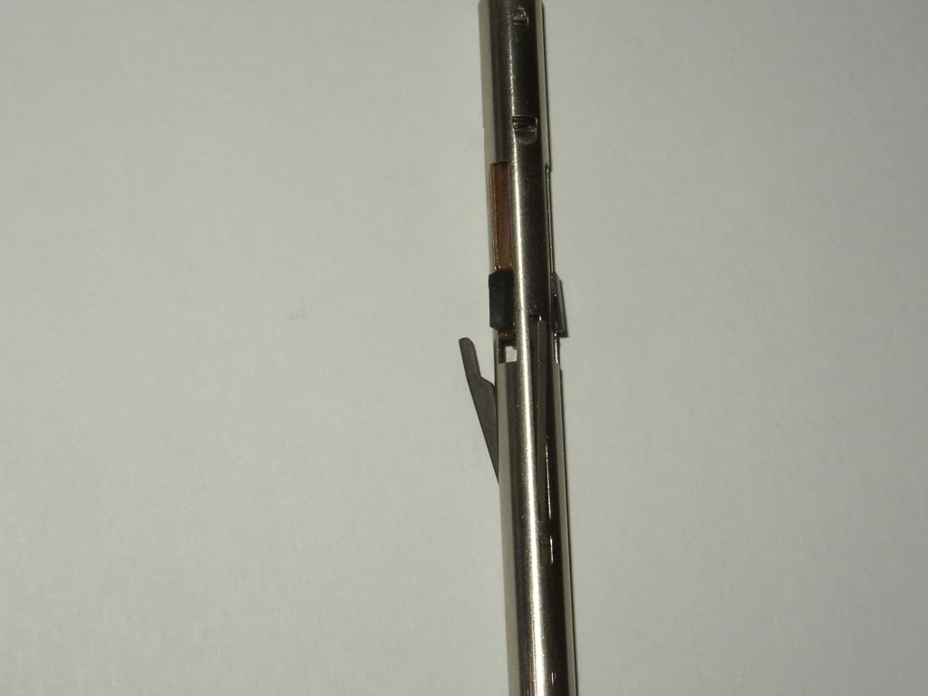

Is anyone savvy to the kind of rubber used in the stopper of the Dual 1019 stacker spindle? I experimented with three 2x2x6 machine keys, which fit perfectly, and which I had hoped would end the temporary nature of the rubber. But they evidently didn't yield enough--on the first trial run, one of them popped out, and superglue be damned. Is there a particular kind of rubber out there best suited for this, and where might I find it?

Use contact cement, not super glue. Super glue doesn't work on porous materials like rubber.
I used some vinyl from a worn-out waterproof boot (footwear) I cut up, trimming it to size with an Exacto knife.
I have had very bad experience with rubber parts on Dual record changers. They rot away.

I used rubber from a turntable belt, it takes 3 pcs glued together to get the right thickness and if your careful you can glue these on without taking the spindle apart. I used tweezers and superglue(believe it or not) and it works perfectly. Mark :D

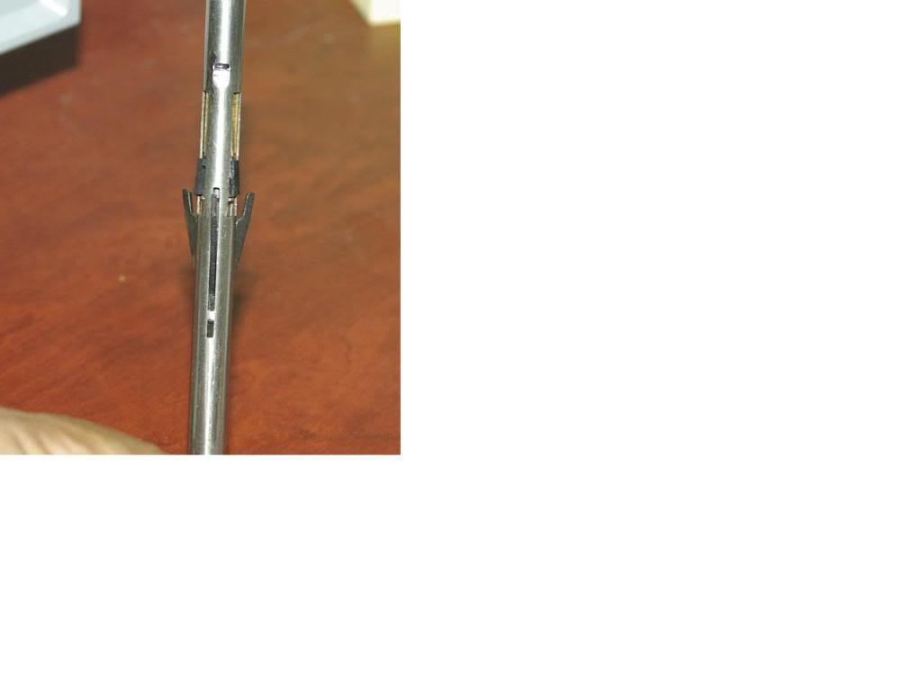

Imagehere is a picture of one of the spindles that I rebuilt. Mark P.S. I am pushing up on the bottom of the spindle to make the pads stick out so that you can see them.

Many thanks to member markl! I copied your solution and my spindle worked great on the first try. I will probably fabricate another set and be more precise with the size and fit, but this first batch is working fine. Thanks again!

I also had a non working Dual 1009 spindle. For my try I ended up using a rubber Jar Ring for canning. Those are a bit hard to come by anymore, but ebay or antique malls may have them. Perhaps even some odd stores still stock them.
The rubber is a good body for holding up the records. I took a straight razor and cut it into three little pieces to fit the pads then I sliced it a bit thiner by turning it sideways so that it was the right thickness to fit within the spindle. I used "Tacky Glue" for my final try. I took a tooth pick and rubbed a thin coat on the rubber then with a tweezers I put them in place. I let it dry for two hours, and its working great so far. I don't know if that tacky glue will hold up to use, but I will find out. If not the same pads would work another glue. I used the tacky glue because I had it here, and it has proven pretty good at hold dissimilar items together, but not under the stress these will have. Time will tell for sure.. Either way its great to have it running.
