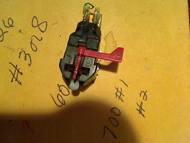

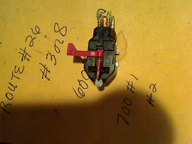

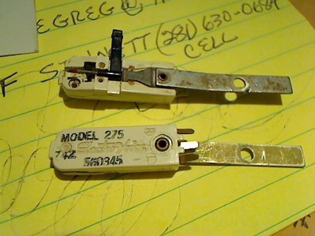

It would be easier if you got the number(s) off the cartridge to make sure you find a corresponding stylus. Like below, is an Electro-Voice Model 275 with a Magnavox number of 560345. That helps to zero in on exactly what you need or find a suitable replacement. This is just an example, but this cartridge can accept several styli. The differences are slight, but they still work. I used to get mine from Radio Shack online for about $4.99 to $6.99. If you can post a pic, that would be great, too. There are many good folks here that will come to your aid. --BB

You probably have the EV-26 cartridge for that player unless someone changed it out. The needles you need are 352-S3 for 78 and 352-D7 for 33 and 45. I used to tell folks to go by gold or silver but that no longer holds true...if I recall it right. It came to haunt me. Nevertheless, any of the big Ebay sellers can fix you up.
