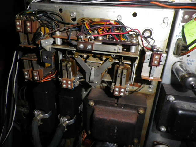

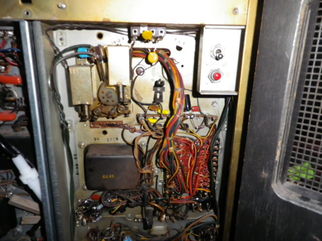

Finally found time to pull the back cover off. I am a little confused, as I can only find one thing that resemples a "wheel" and that is the nylon toothed gear in the upper left area and it returns to the "home" position. Where are the other "wheels" located?
I have looked at stepper contacts and ones marked NC seem to be closed.
I can get the mech to move if I manually operate the contacts on timing relays 1/2.
After manually operating all of the stepper contacts, the selector keys operated twice, as did the wom, now it is back to where I started?
Darrell
