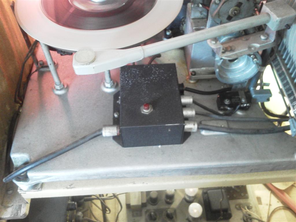

I checked the fuses earlier, all 3 are good. I didn't see any additional fuses unless they're hidden elsewhere on the unit. Here is a pic of the "reset" button.....red button on the black relay box.

I am not sure--but I think that switch is the (record) reject, aka, cancel switch.
When you say you "checked the fuses"--were any of them larger then what they were supposed to be ? Did you use a meter, or test lamp to do so ? If they truly are/were, the correct size, type, and good, you will need to check all voltage readings next, to determine which circuit is failing--Ron Rich
