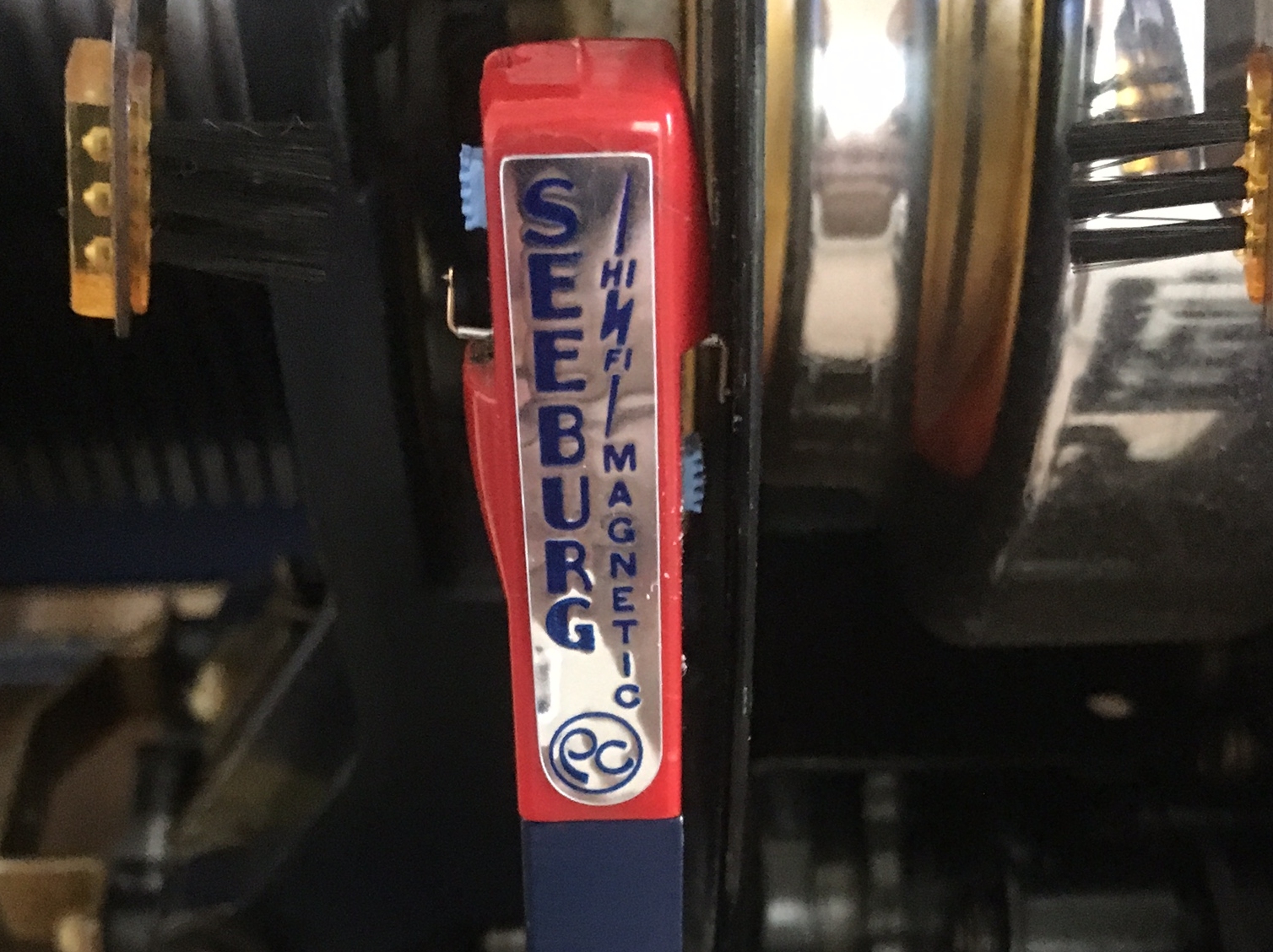

Basically once I got the jukebox functioning 100% I began a long (VERY SLOW) aesthetic restore. Today I was going to wrap this up and I finally broke out an original Red head cartridge that I bought on Ebay and some new "Needles 4 Jukeboxes" Pickering styli. I adjusted the tone arm tension after installing the cartridge and fired it up and I have a bit scratchy sound and roughly 1/2 the output volume I believe I should have.
I've tested the amplifier while the record was playing (to get around the mute circuit) using my phone as a music source, and the amp and speakers sound much better and louder. I am just not getting decent/clean output from the new stylus. I have a brand new RCA plug installed at the amp and that looks good. I checked the tone arm wires and they seem securely soldered to the mounting block. I did change out the old speakers to the recommended Jenson MOD series. I believe I have them wired correctly, I tested the original speakers polarity and wired the new speakers the same way as they would have been on the originals.

Thanks Ron, I balanced the cart using the wheel under the mech, but I just can't seem to get the right tension on the tone arm. No matter how low pressure I try to get it to track, it chews up the record. You can see the dust! Looking at the stylus, (Image 2) it almost looks like the cantilever is extending beyond the stylus tip. Maybe that is dragging on the record and causing poor contact?

Do you have the required gram gauge ? Did you check the balance adjustment as per the manual--?
Is it "chewing up" records at the start, middle, or 3/4 ths of the way through the record ? Ron Rich

Ron, I used the dial to set the balance so it minimally (very hard to do) fell inward or outward from the center of the record. I think I'm going to have to buy a gauge but get the tension 100%. But good news, I just angled outward the "dog ears" of the tension spring rather than keeping them vertical and that lowered the tension and it's not digging into the record. I also just tried a different newer record and set the auto-volume control to MAX and that improved the output ALOT. I am probably being overly picky here, but turning the main volume above 75% max volume does create more noise than I would like hearing even before the stylus hits the record. It's noticeable in quiet songs at this volume. Bass and Treble response controls seem to work OK.
