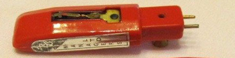

Has anyone seem a cartridge like this before
by Fred S » Sat Dec 21, 2013 8:38 pm
Hello To all
This checks to be OK and it looks like a redhead but will not work in a running Seeburg B or C
Has anyone seen one of these in the past
Thank you and Happy Holiday's
Fred S
Re: Has anyone seem a cartridge like this before
by Rob-NYC » Sun Dec 22, 2013 12:11 am
It is still good...For one thing; seeing how accurately you can pitch it into a garbage can from a distance.
That was one of those ceramic conversion abortions foisted on that industry in the 70's thru early 90's.
When you measure a resistance that seems "good" you are actually measuring the resistor across the ceramic element to cut bass and reduce level for the juke's magnetic input.

Re: Has anyone seen a cartridge like this before
by Fred S » Sun Dec 22, 2013 12:57 am
Just checking never seen one like it. But if they are half as bad as you say that probably is the reason I haven't seen one becasue most of them got thrown away :D
