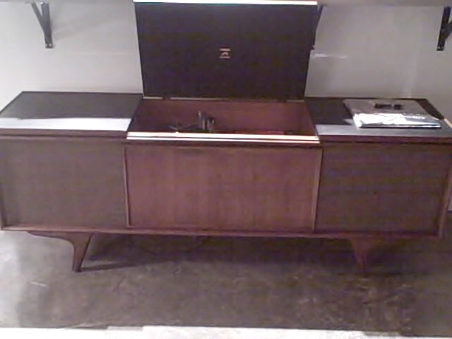

Hello guys, I have had a good time the past 4 hours reading all your posts and there are some very knowledgeable fellas on this site that is for sure. If any one is in the Upstate New York area, I live in Rochester/Syracuse and am looking to connect with other vintage radio/tv/phono enthusiasts. There is clearly a wave of interest in these machines from the 50s and 60s, so now is time to find, fix em and get them back out there! I had a couple of awesome consoles that bit the dust a few years ago and I just discarded them like an idiot.
Well now I am back in the game with RCA Victorola New Vista, Model Number VGT32W, serial number 5513171.
I bought it off a nice fella for $60 and if I can't get it working properly he will take it back. So I am under pressure here to get it going, it fits in beautifully with my house and my GF/roomate just loves it -- if I can get it working. Well enough of the introduction.

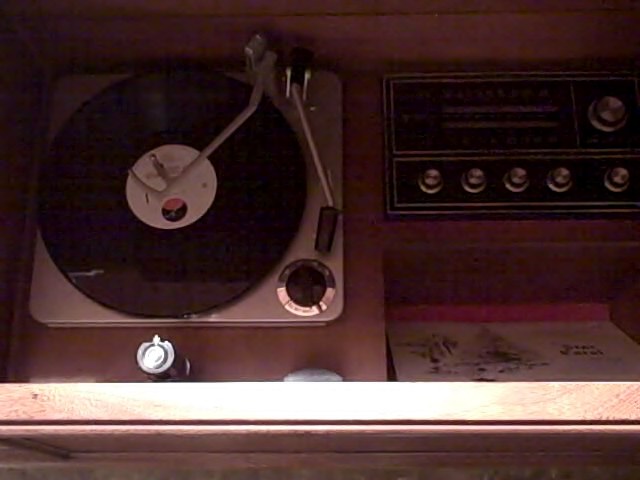

The two main problems, are that the tone arm is stiff, it does not move across the record as it should, it does not automatically go on the record and when I put it manually on there it sounds good though it just stays in the same groove over and over, so this prevents it from automatically moving the arm in place, and also playing more than one groove if I manually put it on there.

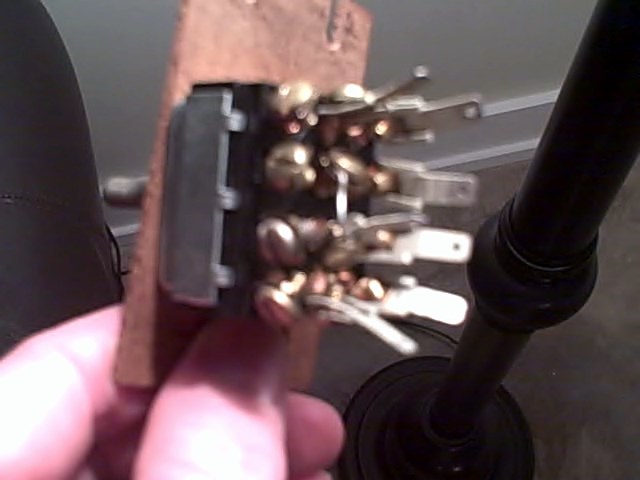

Second problem is that the right speaker does not work, I took off the back panel and swapped the left speaker wires with the right that plug into a something that had a bunch of wires going into it (see photo) and then the left work and the right did not. Do I just need to try and replace the thing that all the wires plug into? Again check out the picture.

The tone arm that is stiff and does not move onto record, if I do it manually it just stays in one groove.
This is the "switch" or circuit board that when I swapped the wires for the right/left speaker, the right then works and not the left, and vice versa.

It sorta sounds like you may have narrowed down the culprit as far as left/right channels go. I don't know what that thing is in your last pic, but it seems like that channel issue is there. It's blurry, maybe pan back alittle bit and maybe show exactly where that thing plugs in. I'm just guessing, but it could be a continuity issue/broken wire, and a meter will confirm that...dead spot between point A and B. It's a beautiful unit though.
Turntables are mechanical beasts and sometimes need a thorough cleaning and lubricating. Check for dried up, crusty grease and cartridge wires have enough lenght to allow the arm to move freely. The idler wheel under the platter should be checked also so it still makes proper contact on the inside rim and is not hard and brittle. There are many more issues when dealing with a turntable. Matt and the other folks can chime in for the specifics.

The blurry photo is nothing more then a "toggle switch". These are prone to get "dirty contacts". If you know how to use a meter, read the contacts with it. if there is a bad contact, or you do not know how to use a meter--you might try this trick, which sometimes works: "Toggle" it very quickly ( with the power OFF), about 100 times. Ron Rich

The toggle switch is what the bottom pic is. It seems like someone modified the wiring so that they could plug in an external tape deck or something like that. The back panel and instruction book (yes it came with the original!!) talk about that spot being for wiring external speakers but those connections are gone, and its place is this toggle switch with four of the spots connected to new outlets to attach a tape deck. I am confident I can fix that, as I mentioned when I switched the speaker wire connections, then the right did work and the left stopped so it must be the connecitons there.
As for the tone arm, I am going to try to follow your suggestions as best I can. I am not so confident in my abilities, I am not mechanically inclined, but I am determined!

If you can find a professional in your area to refurbish the changer (turntable) that's what I would suggest if only because you expressed a lack of confidence concerning things mechanical. The switch looks homade and I would reccomend abandoning it.

1) I have not had any success repairing the turntable, I am so lame, I cannot even get the platter up to do the suggested repairs here.
2) Via Craigslist I found someone that does repairs and he is coming over Sunday night, I will keep you posted
