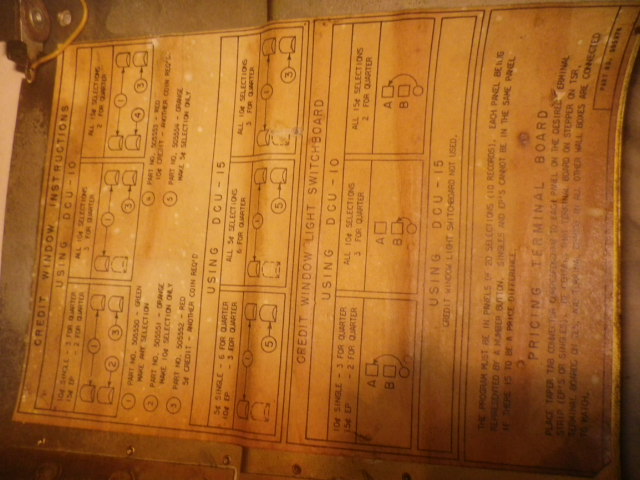

In hopes of saving someone else the frustation I just had, I am attaching a picture of the window instructions that are not included in the manual and that I have never seen before. Being unfamiliar with this unit I was under the impression that after the top two instruction windows went out the the bottom two instruction windows should light up. To my great frustration I could not get the bottom right hand instruction window to light up! Was it a burnt out bulb, a short, a bad socket, out of adjustment. etc?
After viewing these instructions it was obvious to me that there was nothing wrong with the WOM and that it was operating as intended!
Thanks to all for the assistance in getting this WOM to operate again.
Darrell

Someone sold you an "el cheepo" copy of the manual--it's on page 12096 of my copy--along with about a page of "explanations".

Yeah, but, the price was right :D There is a juke box repair person that has numerous SEEBURG Manuals on his web site for downloading. The one I downloaded has 16 pages (my numbering as the pages I have are not numbered like yours) and appeared to be complete. Obviously you gets what you pay for :lol:
