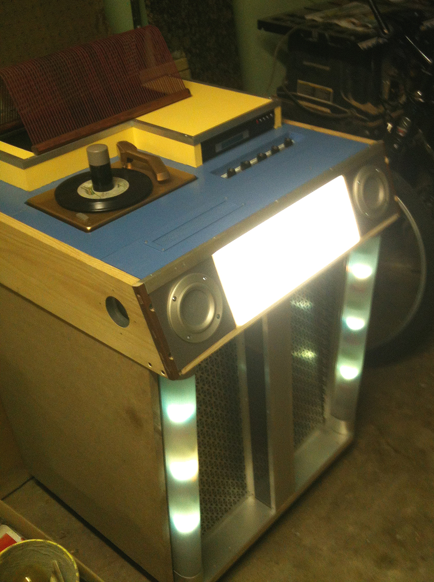

Me, I prefer to play my records horizontally, the traditional way.
HOPEFULLY, this spring, WHEN I GET THE TIME (I'm a busy guy!!) I will have FINALLY finished building my HOME-MADE Jukebox/CD player system and get it painted and trimmed out.
Then I can move it out of the garage, so I can re-organize my stuff better.
Until then........ here is a SNEAK PEEK at the One-Of-A-Kind......"Concept60"
"It's not finished, mind you"............. a YouTube video will be released upon its completion.
(820.76 KiB) Not downloaded yet

MattTech wrote:Me, here is a SNEAK PEEK at the One-Of-A-Kind......"Concept60"
"It's not finished, mind you"............. a YouTube video will be released upon its completion. concept-garage.JPG
That is a remarkable bit of cabinetry. Good work,... though i would have chosen a better turntable. it will be interesting to see the insides as well.

by MattTech » Fri May 20, 2016 6:20 am
Well Rob, thanks.
Here's the "design stats" of this beast.....
Stores 60+ records in the rack.
200 watts, driving 4- 10 inch air suspension woofers, plus 4 - cone tweeters (all Technics brand)
Speakers are protected by a 3-way fail-safe system I designed for it.
Sequential multi-color pilaster lighting, along with music-activated 4 channel / color lights. (all designed from scratch by me)
A CD player capable of MP3 disk playback / w remote. (100+ songs on one disk)
A microphone input for making announcements or sing-along.
The RCA Victor RP190 changer stacks 12 records, has been highly modified w/DC PWM drive system and remote-controlled "reject" capability, also a light-tracking cartridge and damped changer suspension.
I'm in the process of working on the "hood" assembly - with lighting, cutting the plexiglas, etc.
Then comes the two-tone painting, detailing, aluminum trimming out of the cabinet, etc.
It's on wheels thank god, the thing is starting to get heavy.
I went with 3/4 inch MDF & pine for main cabinet - braced & built like a tank.
The "works" are all easily reached under the lift-up center panel that the changer/CD sits on.
But I built this thing to take "abuse" and hardly require servicing.
I'll get more photos when I can.
The thing sounds fantastic so far, it rattles all the tools and stuff hanging in my garage and I barely hit 1/4 volume.
