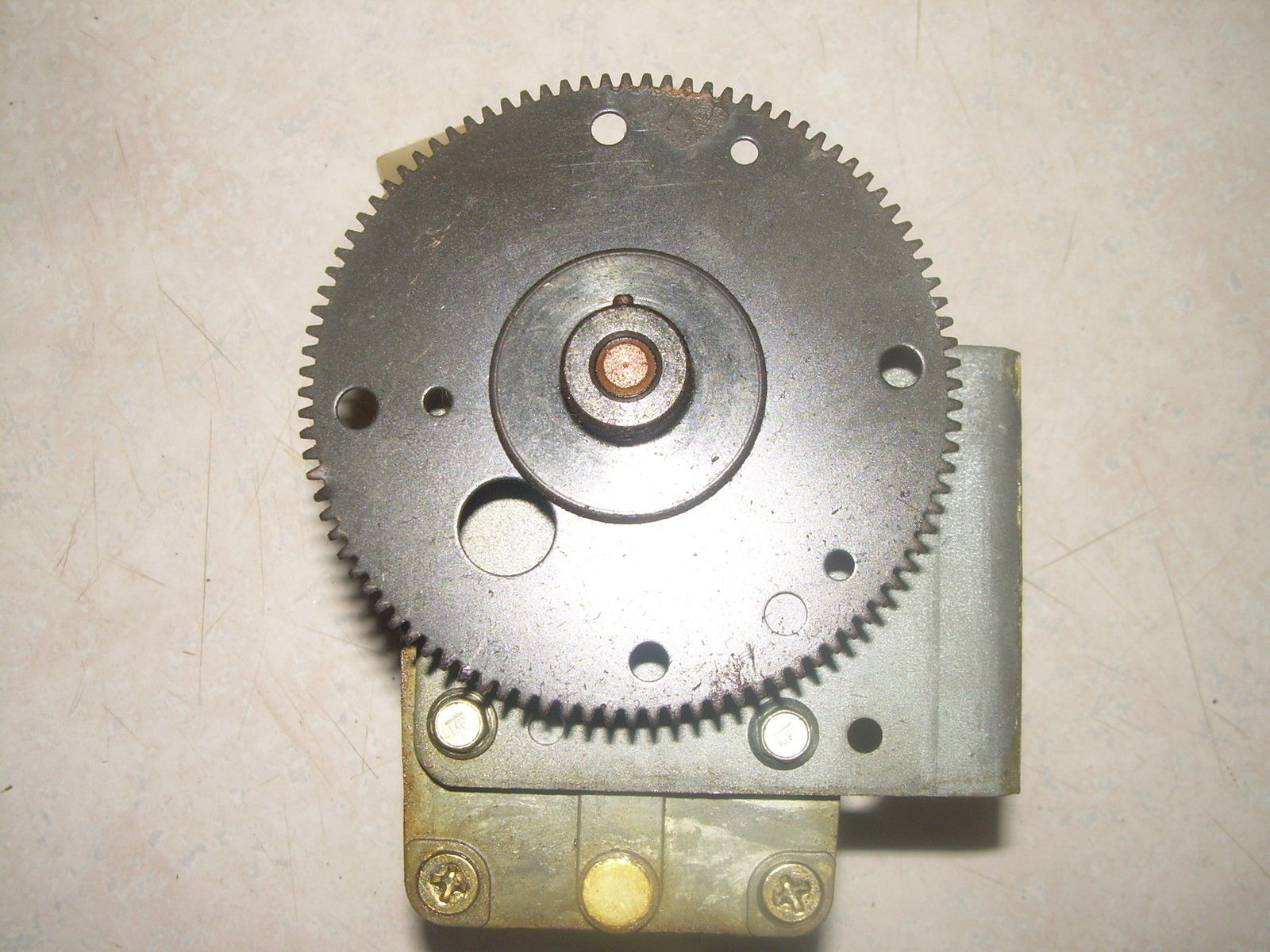

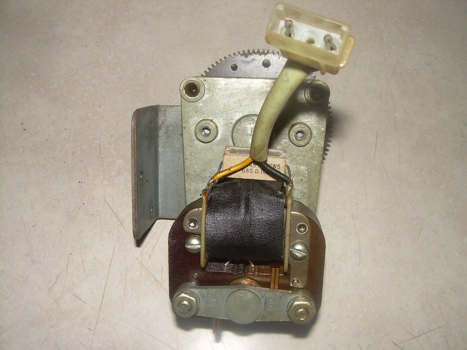

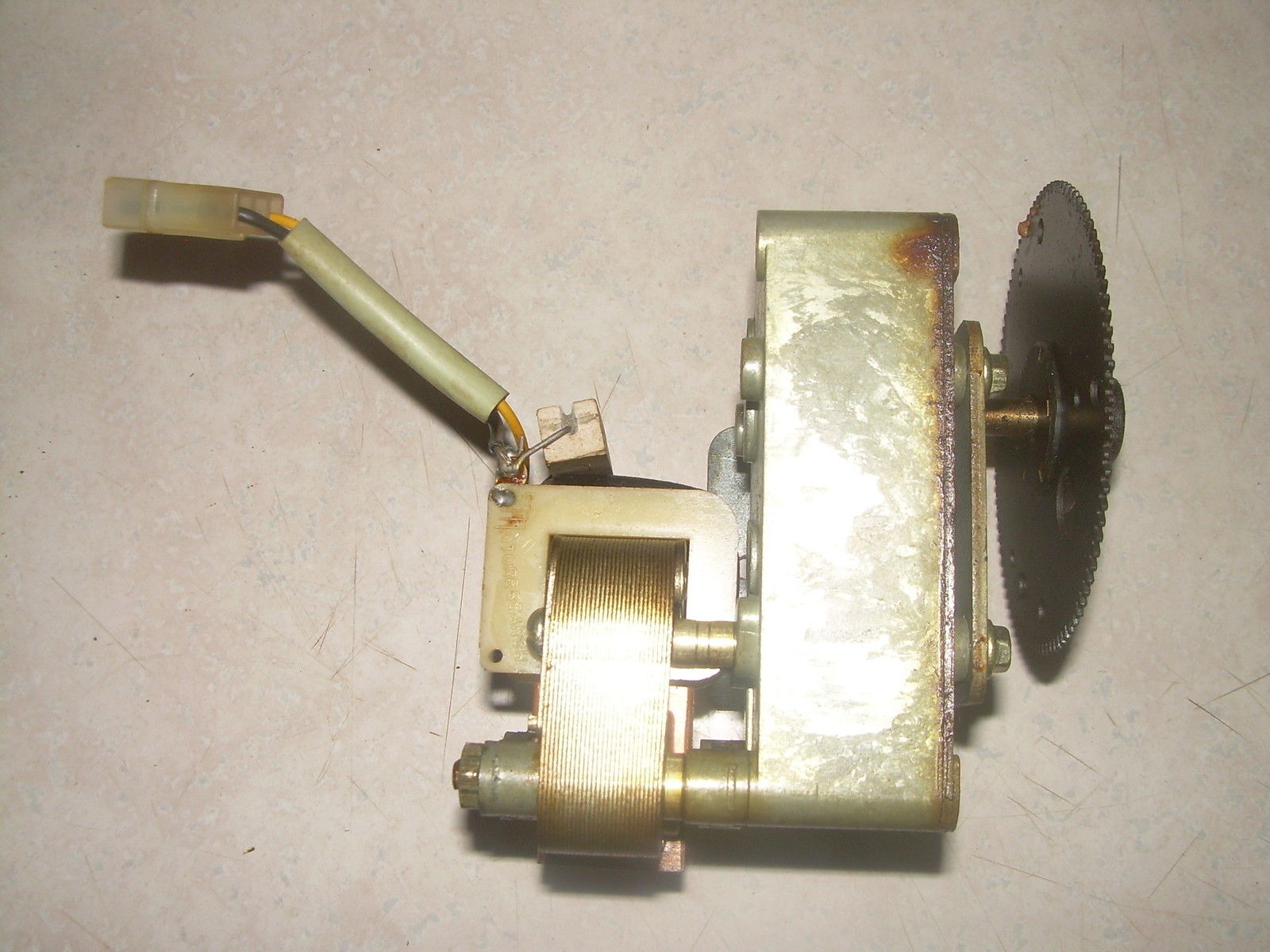

Yeah, I'll be honest, I have zero experience with AC motors. I have no clue where any part of what you're talking about. The ONLY thing I see that looks like it's moveable without taking anything apart is what looks like a metal V-shaped brace from inside the coil with the power cable attached to it against the metal block that goes through said coil, and that everything is attached to, including the gearbox. Mine looks identical to the one in these pictures. :oops:
(258.6 KiB) Not downloaded yet
(287.69 KiB) Not downloaded yet
(232.78 KiB) Not downloaded yet
*edit* If there's some kind of 'clutch' holding this thing in place and keeping it from turning I can't find it.. What I'd really like to do is open up the gearbox and de-gunk everything in there, but I can't even get to all the screws I think I'd need to in order to open it. This thing is literally locked up solid... it won't even begin to turn.
I did just check the power at the connector. Looks like about 25 VAC when the third selection button is pressed. I can feel the hum of the coil when I plug it into the motor and it's active, but no motion at all, and can't turn it by hand either way.
