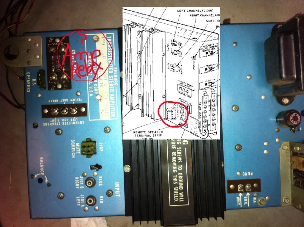

Here is my amp
Re: Seeburg LPC480
by Ron Rich » Sat May 21, 2011 6:36 pm
OK--does the TES latch bar solenoid energize ? If so, remove the mute plug from the amp, and BRIEFLY short all three contacts together in the WIRED side (going to the mech) of that plug--this should energize the trip coil on the mech, if it's in play position.
The mute relay is indicated inside "dotted lines" to inform you that it is, in fact, located on the amp chassis--not necessarily on the top or bottom side. Follow the orange wire from the mute plug, and you will find the relay container. Ron Rich

I did not get the photo before--yep--that is the relay as shown in "dotted" lines, which means it's underneath.
Sounds like it has a dirty contact to me--If you know how, clean it--if not, do NOT mess with it, as it is easily destroyed !!

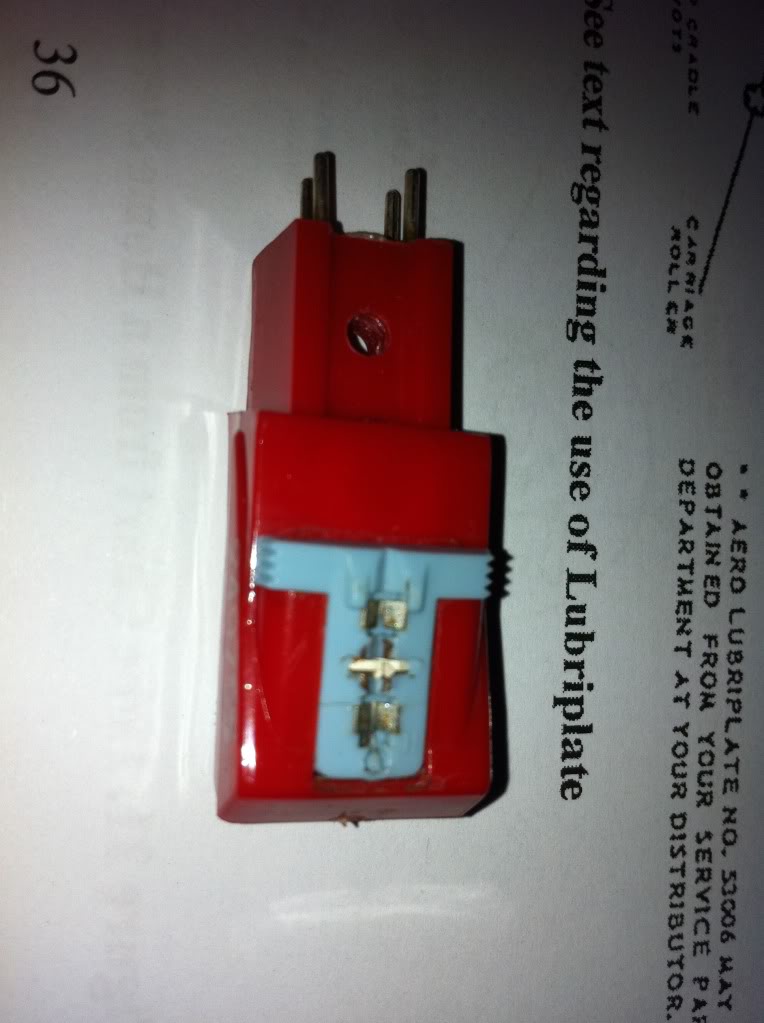

Ron, Can you look at this needle and tell me if the needle is broke? It seems like there is something missing from the middle. I have never seen a good one before since this is my first jukebox. I used your guide and cleaned it up really good and lubricated it. It picks the records up and seats them nicely now! But it doesnt play at all, seems the needles are damaged. The stylus never creaps inward though as it attempts to play, does it only do that when the amps senses it playing?

Judging from the pictures on ebay theres a peice missing out of the center of it(both sides), where is a good place to buy a replacement. I have seen them on ebay for 45 each
