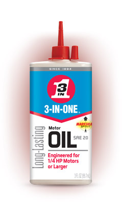

Just wanted to mention, I found 3-in-1 motor oil at Lowe's but it didn't have a picture of a motor on it. It was this bottle:
Same stuff, I assume? It says 20 wt motor oil, just no picture of a motor.
Re: Jukebox Lubrication
by Ron Rich » Tue Aug 30, 2016 1:05 am
Hi Joey,
I assume so also--Plastic-can I just bought has the motor on it, still--got it at a "Lowes" owned store (Branded "OSH") ?
Could be they changed the graphics--again -- Look at the back of it, down low--does that can say "dist by WD 40" ?
