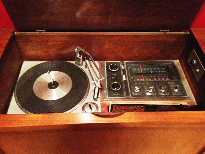

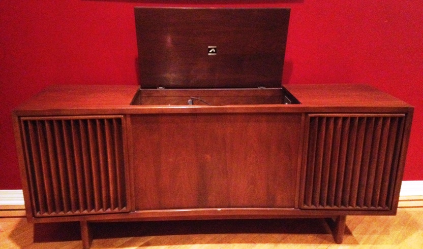

Hey all, just got a great RCA Victrola New Vista Model VGT 61W. It is cherry and has all working parts except or the needle. I need to replace the needle and fix one lose wire (it only plays out of one speaker). The machine has not been touched since the 1960s - my friend's mom's home was basically a museum of the 1960s. Time just froze and it wasn't used. Except for some dust, it is in showroom condition.
1. Serial Number 60-4526 Model 8 43
2. Needle area says 16277 001 204-2 RCA
3. Needle area hangs down. Is this normal?
How hard would this be to fix and get a new needle?
Thanks so much for the help!

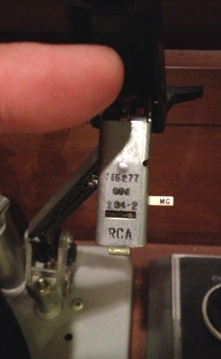

This cartridge hangs down. Is that supposed?
New Vista 3.jpg (95.65 KiB) Viewed 4999 times

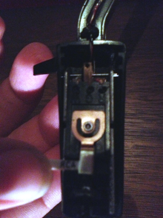

The needle is broken off I think. It does not play a sound though when I draw my finger over the end, it makes a sound.
New Vista 2.jpg (132.7 KiB) Viewed 4999 times

the needle itself seems to be gone. Does the whole arm need replacement or can I find a new needle somewhere?

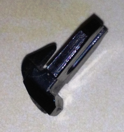

I am excited (hopefully for a good reason). I just found this little black piece in the cabinet. I am enclosing two pix for you.
Is this the retainer? It doesn't seem broken at all.
If it is, how and where do I attach it to make it work? is that I will need to do to get up and running?
Thanks! :mrgreen:

1) The cartridge is lifted up into the tonearm headshell and held in place.
2) the retainer is slid carefully up the front edge of the headshell with that pointed "arrow" /\ outside the front - facing upwards until it seats. - held in place by friction.
3) the cartridge now can pivot freely up and down (you can test that with your finger)
The projection on the lower inside of the retainer limits the cartridge's front tip from lowering too much.
The upwards "arrow" is a visual indicator on the front of the arm used to place the arm on a record manually.
If there is ANY friction, even slight, while moving the whole arm horizontally/sideways - the lubicant is dried-up and the changer will require complete servicing - not a job for a novice.
Once a new needle is installed, if the changer does not cycle or trip after automatically playing a record - the changer will need servicing.
The same applies if ANY noise is heard from the motor, or if the speeds are not correct.

My problem is that the cartridge does not seem to fit in the head. it is actually LARGER (???). The cartridge extends a little bit beyond the tip of the head when pushed up, so it doesn't go inside. Do you know how to fix this? I will try and upload a pic or video very soon.

Eureka! The last person to mess with the cartridge (possibly in the 1960s) didn't put in in correctly. Instead of placing the bottom bar in the notch, they just tried to pop it in.
I fixed it! Now the cartridge "floats" and the little black retainer is holding it perfectly. Now all I need is a needle! Yee ha!

Ok, last info:
Once a new needle is gotten, it simply snaps in under the spring-brass clip.
