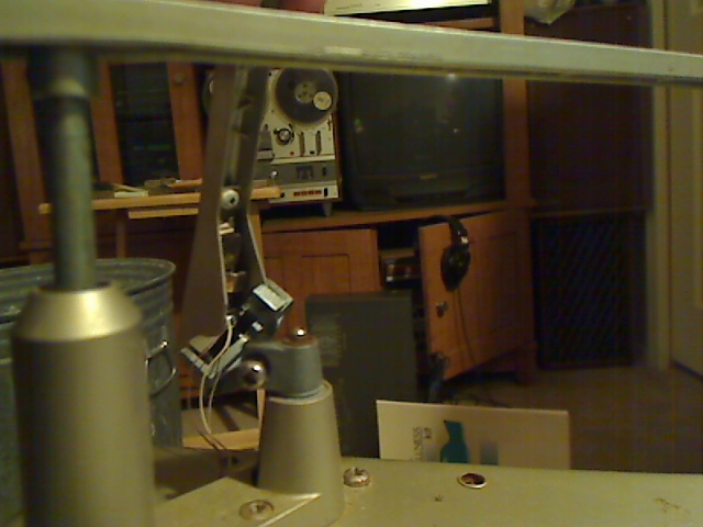

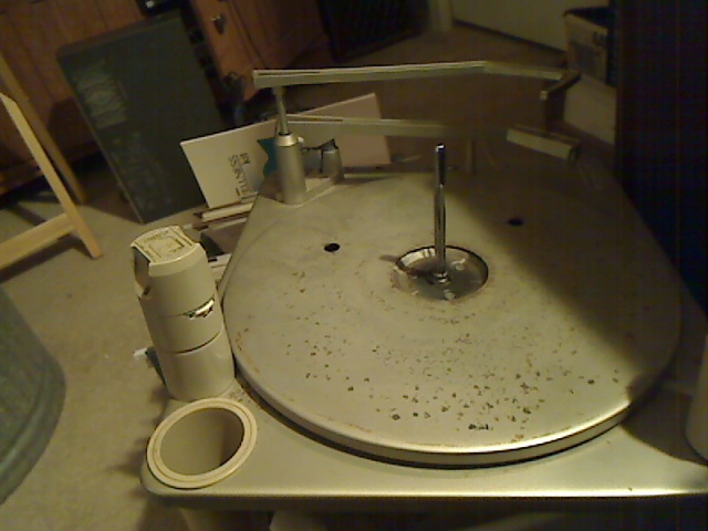

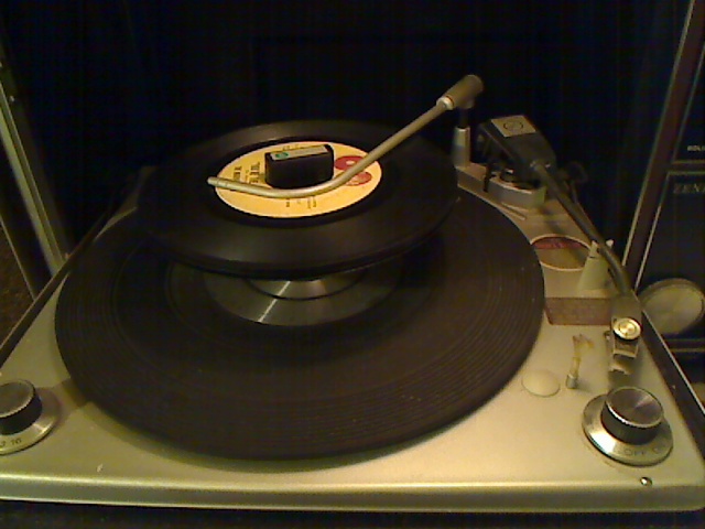

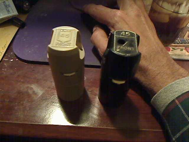

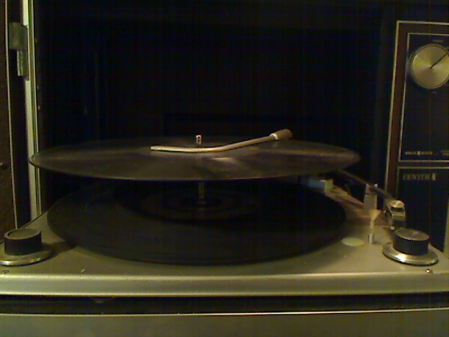

If your changer has the shorter spindle, you would use the beige adapter. If it's a tall spindle, you would use the black one that has a hole in the top. It's about an 8th inch taller and may not align up correctly if you use in on a shorter spindle. Those taller spindles could stack about 12 LP's.
Picture 63.jpg (89.9 KiB) Viewed 1630 times
The overarm supports a stack of LP's or 45's. Those records cannot just teeter-totter and self balance by themselves.
Picture 67.jpg (76.92 KiB) Viewed 1630 times
Picture 68.jpg (83.92 KiB) Viewed 1630 times

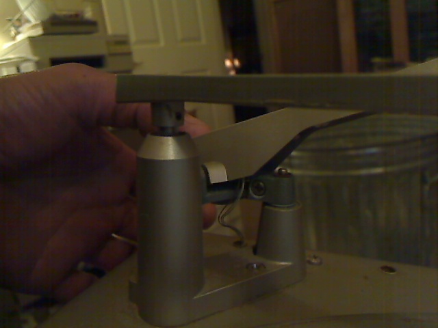

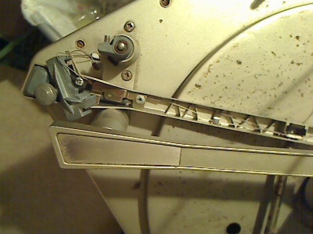

If you want to remove the arm, tilt it up and look at the phillips screw underneath in the center of the pic, facing the overarm. It's the only screw securing it to the post, and be carefull not to rip the cartridge wires. There's only so much wiggle room to work with. "Please ignore the Brandy and Coke in the background." LOL
If you look at your turntable again, the 45 adapter may be sitting in its own little well in the upper left hand corner like the turntables shown below. Okay, sorry for the overkill, but was just trying to be a little hep (I mean help) to someone.--BB

Bobby Basham wrote:If you want to remove the arm, tilt it up and look at the phillips screw underneath in the center of the pic, facing the overarm. It's the only screw securing it to the post, and be carefull not to rip the cartridge wires. There's only so much wiggle room to work with. "Please ignore the Brandy and Coke in the background." LOL
This picture looks very similar to a changer I've got. I did remove the arm by removing this screw. When I put it back together the arm seemed to sit higher than before. I loosened the screw and then it didn't seem to "feel" right. I tightened it back up and put a record on and tried it and it worked.
Does this screw or taking the arm off dictate changing some setting that I need to double check before really using it or is this screw strictly for holding the arm on and the adjustments are elsewhere?
Re: Our new, old magnavox console - and questions (?)
by Bobby Basham » Wed Jan 05, 2011 7:02 am
Moxy,
Make sure you have the arm seated to the post properly. In that pic that has the arm turned on its back, you see the big thumb screw for adjusting the counter weight/stylus pressure. The sunken screw just above that adjusts the height of the arm, and the other sunken screw up at the end of the pic adjusts how far in you want the arm to set down at the beginning lead-in track of a record.
If you removed the arm and didn't touch anything else, it should perform as it did before when you reconnected it. --BB
