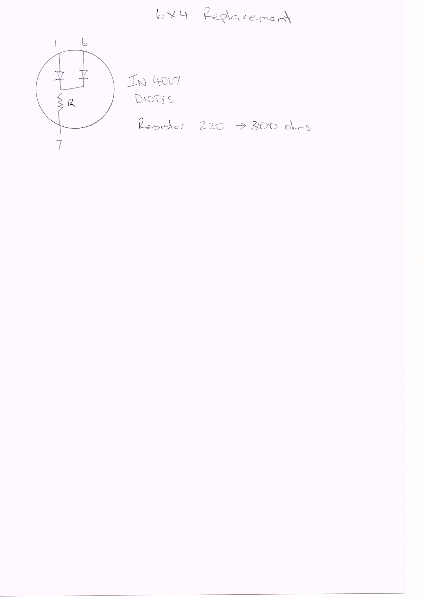

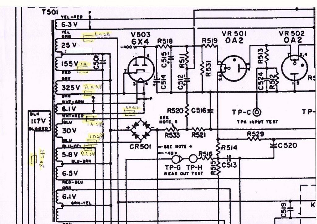

Rob/Ron thanks for the advice i have done a quick drawing of the fuses required.
Would you be able to confirm i have this correct on the schematic?
Ron i will add a fuse to the trip coil inside the mech thanks.
Also Rob you mentioned replacing the 6x4 rectifier using diodes in series and a resistor to drop the voltage.
I would like to do this in the old rectifier base, should the diodes be in series or parrallel ?
Have i got it correct in the drawing or am i way off?

by Rob-NYC » Sun Mar 13, 2016 2:27 pm
John, the only issue I see is the fuse in the line going to the 6X4. 5 amp would be way too much and not needed at all if the tube is to be eliminated. My suggestion was to use that 5 amp fuse to protect the heater winding for the amplifier tubes. I have not done this on all machines, but it is a good idea.
Re: 6X4 Elimination; I remove the red wire from the tran that goes to pin 7 of the 6X4 and, as shown here, connect it to the first of two diodes:
http://s1192.photobucket.com/user/Rob-N ... rt=2&o=212
then through the resistor and onto the inline fuse holder (large red wire) and to the first filter as original.
The diodes used are whatever I have that can handle the current & voltage. Here they look to be 1KV-1amp.
This is from a TSU-7 (1962) whose transformer was ruined by a water leak. It was rebuilt by me in Feb. 1998 and used on location for approx 16 years w/no problems.
