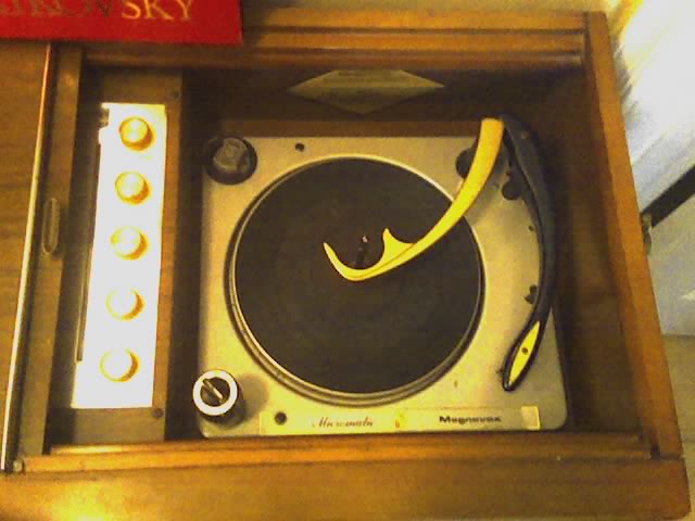

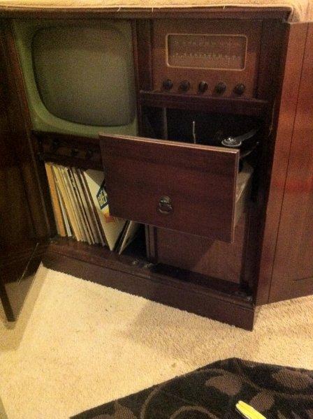

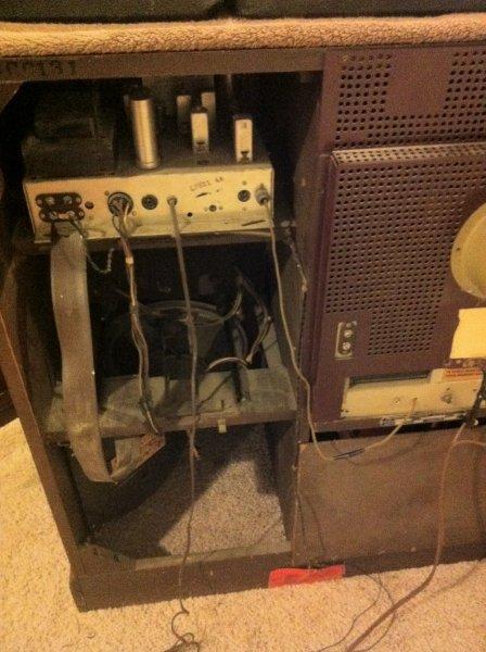

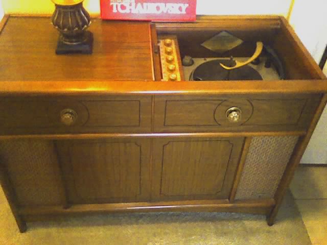

Can anybody tell me where I can get more information on this thing? It has been passed down to me from my parents and I would like to tinker with it to get it back to fully working order. Everything seem to be powering on with the replacement of a power cord, but the turn table does not always engauge, and is rubbing on something slowing it down. I can't get the FM radio working, but the AM works great. The TV still powers on and all glow plugs seem to light.
I'm looking for any kind of manual, schematics or even the year of this.
Thanks! All help is appreciated. I can post more pics if needed.

Very nice!! The rubbing noise you are hearing from the turntable is most likely the dried out rubber on your idler wheel - the rubber coated wheel that the motor drives to drive the turntable. They get hard as a rock over the years, and then provide no 'grip' to move the turntable. Most seem to be available online, 2 sites I know of are www.west-techservices.com and www.turntableneedles.com. The 'glow plugs' you speak of are actually called vacuum tubes (or just tubes for short), and just because they light up doesn't mean they are functioning. Just a little info to get you started, the fellows on this site have much more experience than me, and can probably help you much more. I have found some pretty good info on some of my sets simply by googling the make and model #. Hope this helps a little!

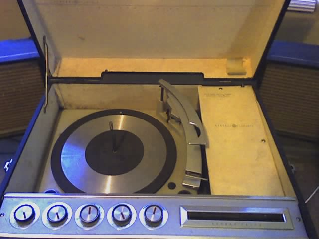

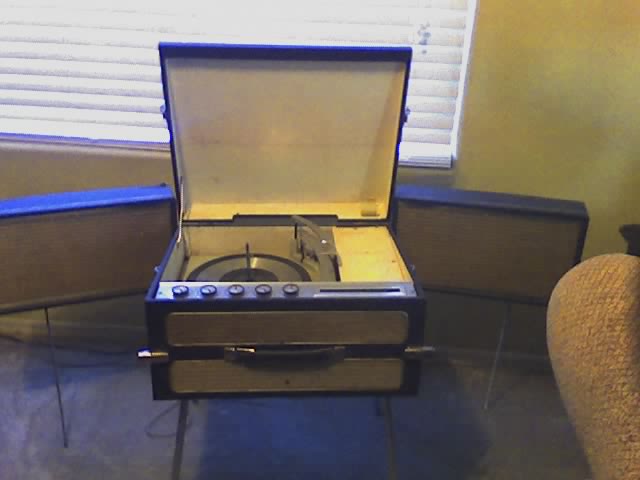

Anyhoo, as far as those older units go, TV's can be extremely dangerous, and tube amps aren't anything to "tinker" with either. Some of their issues are different than Solid-State amps. The only tube units I have would be a Maggie console that I did a cap job. Phono played great, but the radio was dead. The radio plays well now. Oh, I do have a heavy portable that seems to be behaving for the time being. It's amazing how one part of an amp fails while the rest keeps churning on. --BB
