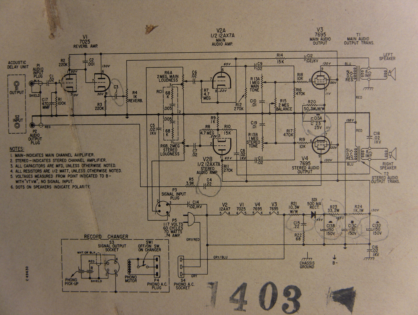

Here's the schematic and parts list that's inside the cabinet.

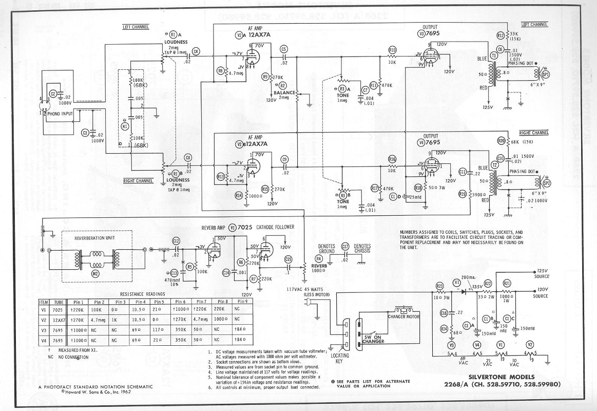

Here's the Sams schematic.
Silvertone 2268A-5594.JPG (503.79 KiB) Viewed 671 times
The differences in the 2268 and 2268A chassis are as follows.
The loudness compensator couplate in the 2268 has 100K resistors, mine (2268A) has 68K resistors.
The capacitors going to the positive speaker leads in the 2268 are .01, mine (2268A) are .02.
The resistors just in front of those two capacitors are 33K (left), and 68K (right) for the 2268, and mine (2268A) both have 15K.
The tone control has .004 caps for the 2268, and mine (2268A) has .01 caps.
ALL is wired according to the schematic posted inside the cabinet, for the 2268A
Something I noticed that doesn't jive between the Sams schematic, and the original cabinet schematic is how the negative of each transformer is connected back to circuit. My wiring (in line with the cabinet schematic) show the negative of the left channel going directly to chassis.
The negative of the right channel is connected thru a .02 cap to B-.
The Sams schematic shows for the 2268A the left channel negative going to directly to B-, and the right channel negative going thru a .02 cap to chassis.
Which one makes more sense?
And how is the voulme pot wiper bleeding treble to the home stereo amp?
Am I barking up the wrong tree?
