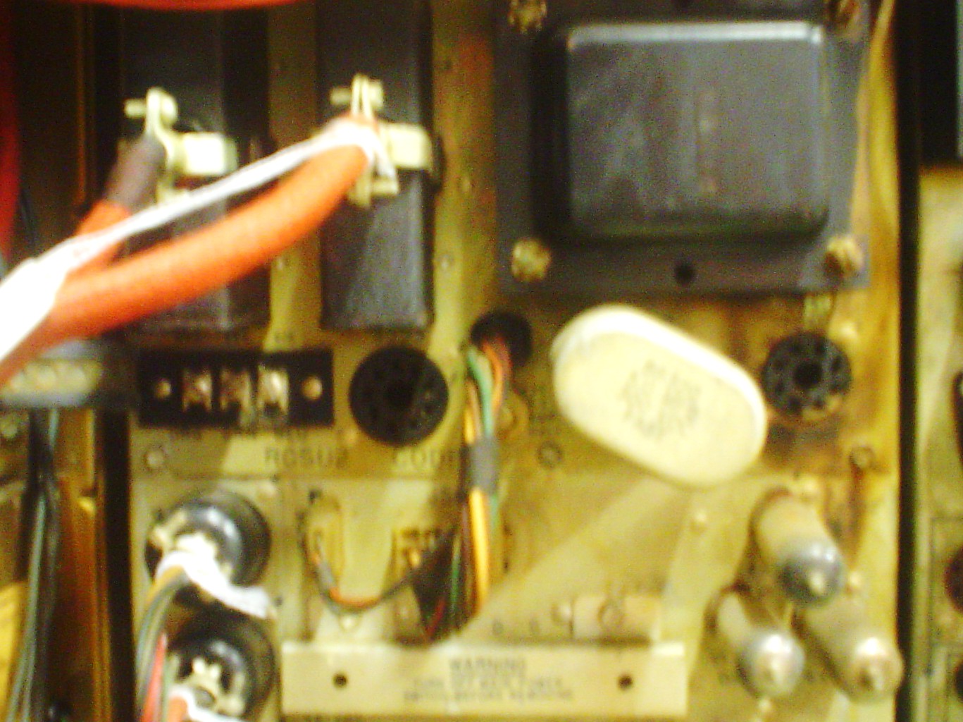

looking for the number of tube missing in the left side of pic i know the rights a 2050.just want to get all the tubes and fire machine up before i ask more questions thanks
the tube to the right that is missing is a 2050 the one to the right is the question at hand

That is for an add-on power supply if you are using more than 6 wallboxes. You don't need it otherwise.

thank you then i just order the one i need for the right side or is that a extra tube too thanks

You only need that tube for stepper operation. No wallboxes -no tube.
