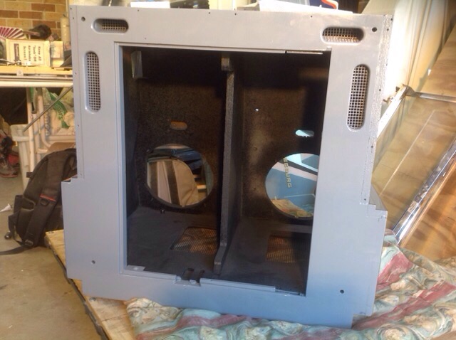

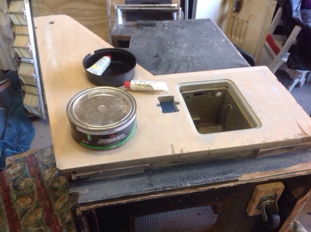

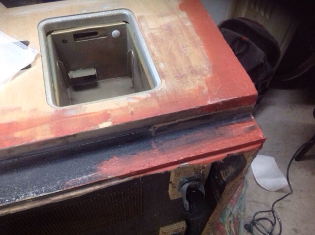

A quick update frame has been patched with fiberglass filler and sanded smooth ready for painting.
Anyone have any good scans of the interior paperwork?
Removing the anti theft screw from the cash box was a bitch but got there with the use of a dremel
I have purchased a as new 500W stepdown isolation transformer and still compiling a list of parts required.
Slow and steady but getting there.
Hopefully have the box painted in the next few weeks.

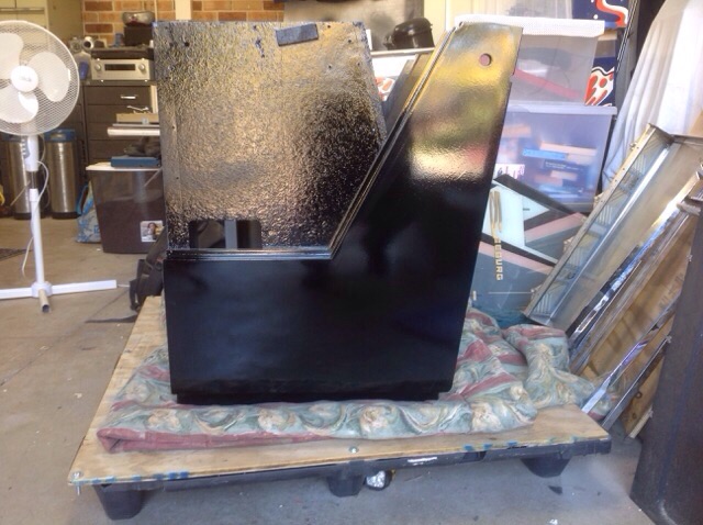

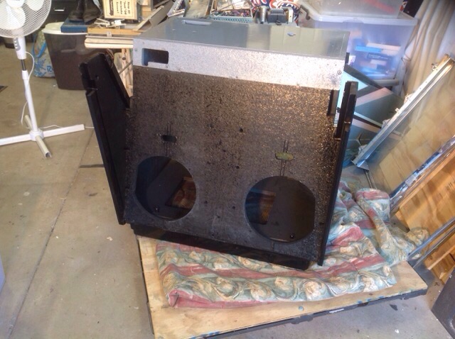

Cabinet painted in 2pac car paint pretty happy with the results.

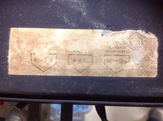

I am after a scan or photo of the service switch decal, as you can see there's not much left of mine.

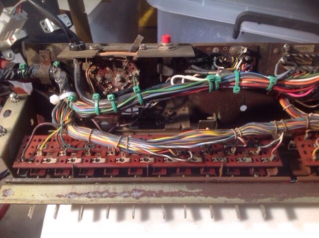

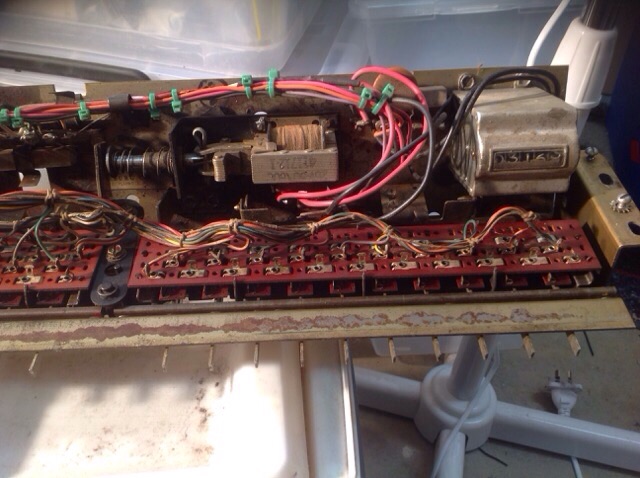

Any tips on the best method to clean the tormat electrical selector 60 years of gunk has built up inside.
Re: Seeburg 222 restoration
by Ron Rich » Sat Aug 15, 2015 4:01 pm
What I do is remove it from the phono, then remove the solenoid, then dunk it in a bucket of hot "soapy" water, then a hot water rinse, then re-wash it using ("sudsy"--if you can get it) ammonia, followed by another hot water rinse--then a total dry, and re-lube, before using.
BTW--good luck on that scan--I have not seen a good "copy" of that in a million years-I just make the--Scan-Off-Play--

Thanks Ron and Matt I will make up some sudsy , I already have cleaner/ lubricant for the switches.
Ron yeah I'm not getting much response on the service switch decal I will make one in Photoshop but would like to know exactly what was written on the decal.

As for what it said on that paper instruction label on the service switch, I THINK the wording is the same in the I and O manual, where it fully explains the operation of the switch--there were a couple of different instruction sheets used for that purpose--just slightly different.

Ok I spent a bit of time remaking the service switch decal
Can anyone confirm what was written under the Off button
by Ron Rich » Mon Aug 17, 2015 3:41 pm
Not exactly, they changed it several times--I THINK it said something like: " use (either "slide switch", or "push button" switch--whichever type was installed) twice, to stop motor when in this position. Ron Rich
