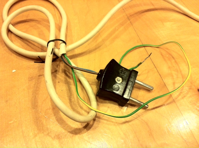

Hello All,
Newbie here, with possibly a newbie question (I may have a few, and some for different subfoums too lol).
I picked up a Garrard SL-95b, as it was the one I grew up with in the 70's, as the Mrs and I are getting nostalgic for Vinyl. Whatever your opinions are of this model aside (this was a sentimental, neither an audiophile nor a collector's buy), mine comes with an odd power plug.
It's two pronged but the distance between the prongs is wider than conventional US plugs, and it has rounded tips and shafts. A third wire is protrudes further up on the cord and is for the ground.
Is this a plug for a console power supply or perhaps an international outlet?
The Plug
I would like to convert this for use with a US hospital grade power strip. How can I do so?

Since you did not fill out your "country profile", I don't know where you are--but if you are where the power supplied is "117 vac/60 Hz.", use extreme caution, as that's a German style power plug, that MIGHT be set up for "220/50 Hz." Ron Rich

The changer is probably set up for 240V with that type of cord.
The motor as well as the cord will have to be re-configured for anything else now. (120V)

Ron Rich wrote:Since you did not fill out your "country profile", I don't know where you are--but if you are where the power supplied is "117 vac/60 Hz.", use extreme caution, as that's a German style power plug, that MIGHT be set up for "220/50 Hz." Ron Rich
MattTech wrote:The changer is probably set up for 240V with that type of cord.
Uh oh. I'm in the US, which is why I got a US Hospital grade power strip. I got this off eBay from a seller in NE. I didn't think it would be configured for European power coming from NE.
Were the Garrards made specifically for target markets, or did they have one unit for all, but differing adapters? I seem to recall my father's had a US plug, but may have had a plastic box along the cord that may have been a converter? it's been over 25 years since I last saw it in person.
How does one go about reconfiguring the motor?

"AWC" first thing is to examine the motor and look for any voltage switch. -Some- Garrards intended for the international market had 110/220 switches.
Go here fro a manual: http://www.vinylengine.com/library/garrard/sl-95b.shtml
In some cases phono motors can be rewired for 110, probably not practical here though.
There is also the problem that this is a synchronous motor and the pulley on it's shaft will be sized for 50Hz operation, thus it will run way too fast on 60Hz.
You can by a cheap step-up transformer for well under $20 but you'll still have the pulley problem.
Easiest solution: Replace the motor with a 110/60 from a junked American table. Garrard made millions of turntables and sold the bulk of them here (USA) so you should have no trouble finding one. It does -not- have to be from the same model table, however make sure that the inner rim of the turntable of the donor is the same diameter.

Thanks Rob/NYC. Apparently I lucked out. My "International" Garrard (as it is stamped on top) had a box inside where all I had to do was make sure it was wired correctly on 4 poles to run in the 110 range.
I consulted with others on http://www.vinylengine.com/ (I found a similar post in their Garrard forum) and I am good to go. :D While I don't have a strobe to confirm, the test records I've tried all sound correct (no Chipmunks sounding like Paul Robeson or vice versa :lol: )
