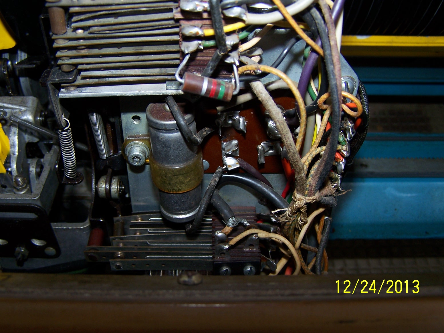

Ron
I sent you pictures of my motor terminal board and never got a response. you mentioned something about about not needing the small cap on the terminal board that is why I sent pictures. Please look at and avise.

Re: Record Speed
by Ron Rich » Thu Dec 26, 2013 1:14 am
Hi Bob,
Did not respond, as I did not get them- Just cut both wires at the terminal board.

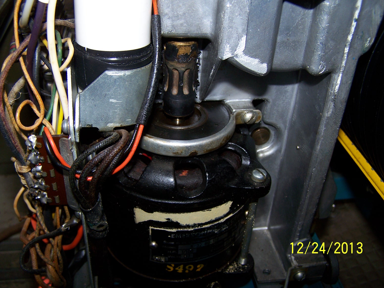

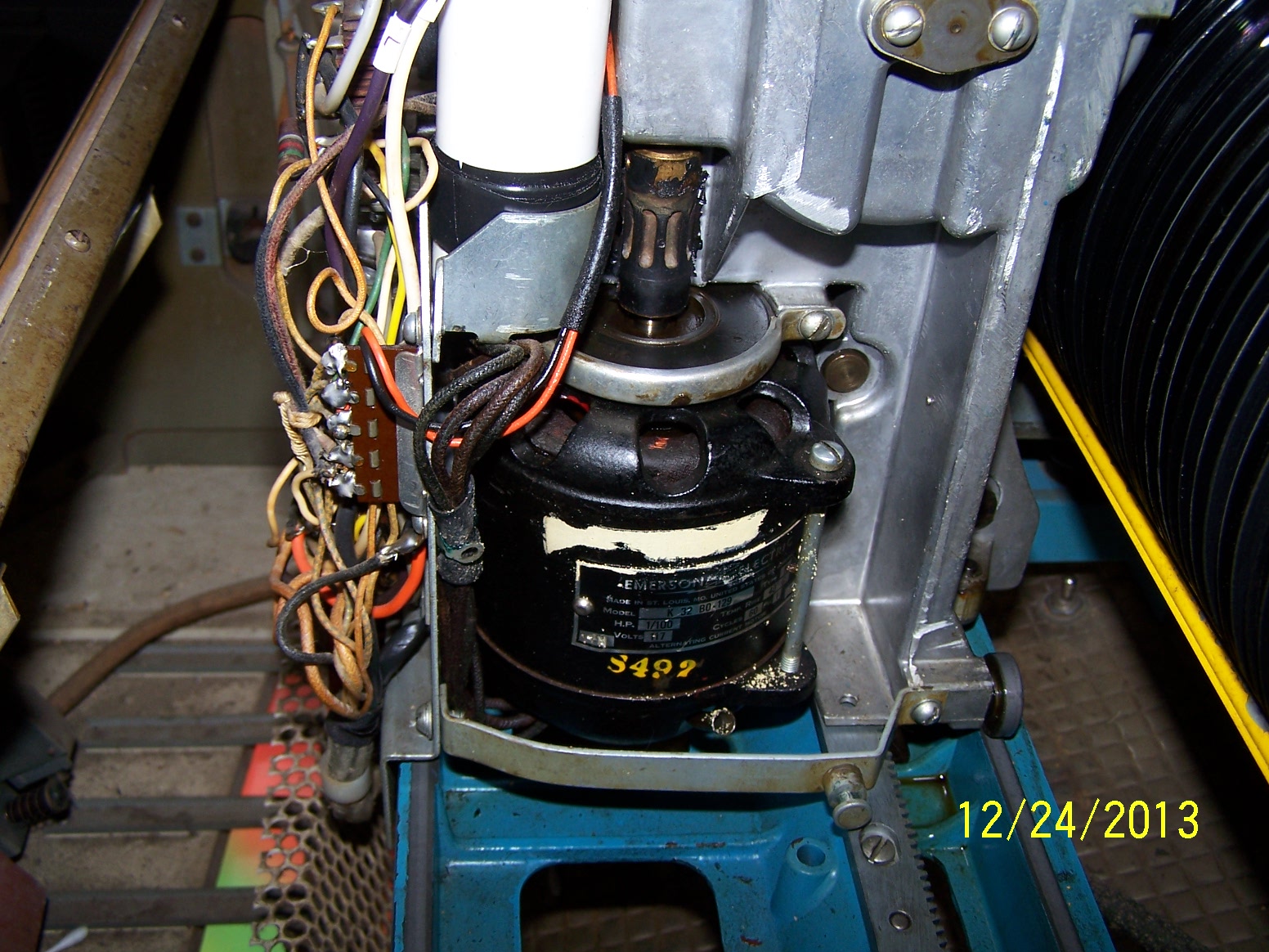

Not sure what I am looking for. Sending pictures again. Motor has no place to oil it and is saturated inside.

by Ron Rich » Thu Dec 26, 2013 6:04 am
Bob,
Get thee to a drug store--purchase a flashlight, and some reading glasses :lol: --that motor has two "places" to oil.
One is on top --it's just a "hole in the rubber" below the motor coupling --in the rear--difficult to see, but it IS there--other is the brass oil cup sticking out down below--
What are you using for oil ?
Yes--that's the small cap that should have been eliminated--years ago--

Is the second section of the motor capacitor not being disconnected while in play mode? On your machine that will be a large gray wire coming from the capacitor to a blade on the vertical stack of contacts on the front of the machine. If these stay closed during play mode the motor will skip-phase and flutter will occur.
